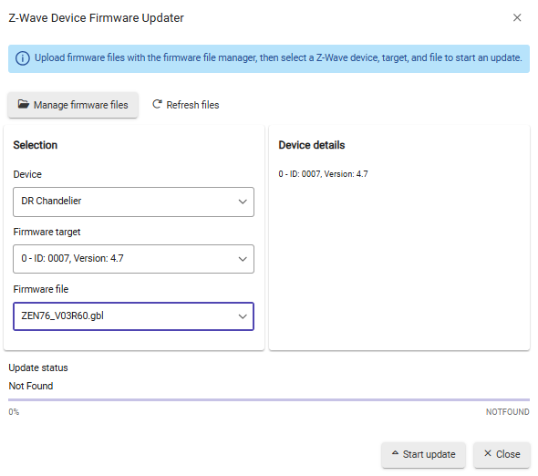

Post a screen shot of the firmware updater before you start the programming so we can see the existing file and the new target file names.

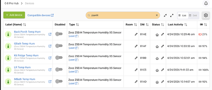

I have two ZSE44 units. One is paired mesh the other LR. Both work fine and have OK battery life.
I have one on firmware 2.0 and the other on 2.3 (LR) one.
I'll try updating the 2.0 unit now and see how it goes.
I'm running 2.10 and my batteries have been in since mid 8/25.
C8Pro, LR

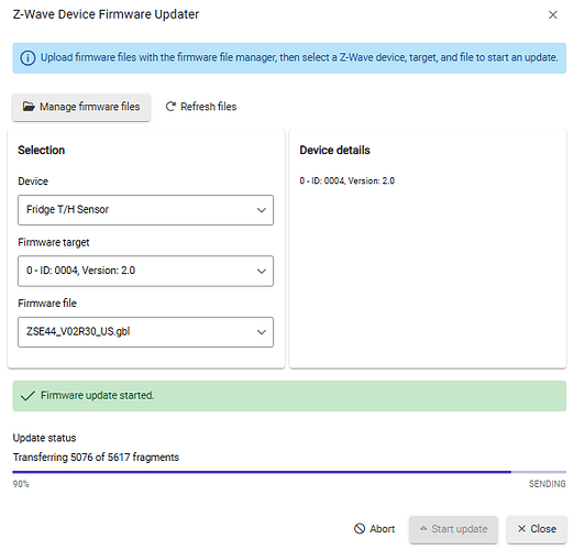

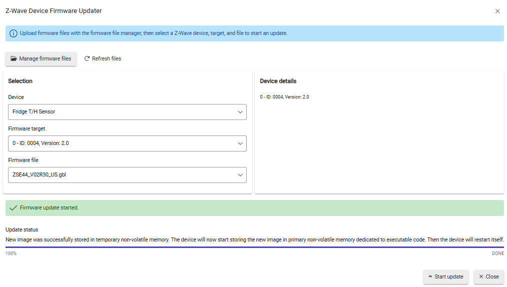

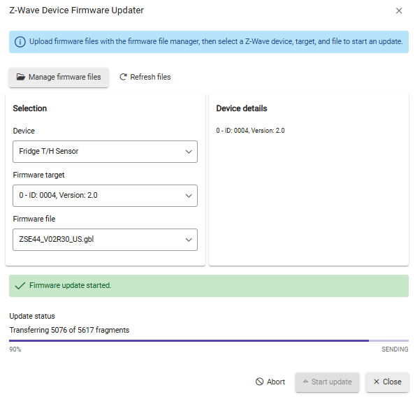

Worked.. It did take a while for file transfer, about 10 minutes. Seemed slower than line powered devices. Maybe cpu with battery powered devices is more minimal?
four quick clicks of button to wake up ZSE44 and blue led should flash indicating awakened,
After:
Before:
Completed file transfer:

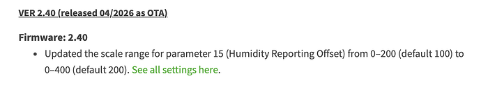

Why didn't you go with 2.40?

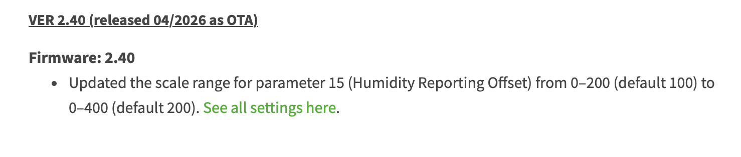

I didn't notice a 2.4, I guess I'll do that one now. That must be a recent zooz update
This is a Hubitat platform release version. 2.5.0.123 is not a beta release.
That's a Zooz firmware version.
