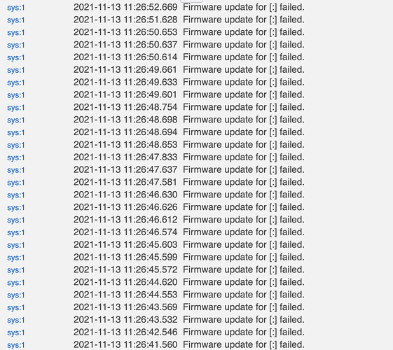

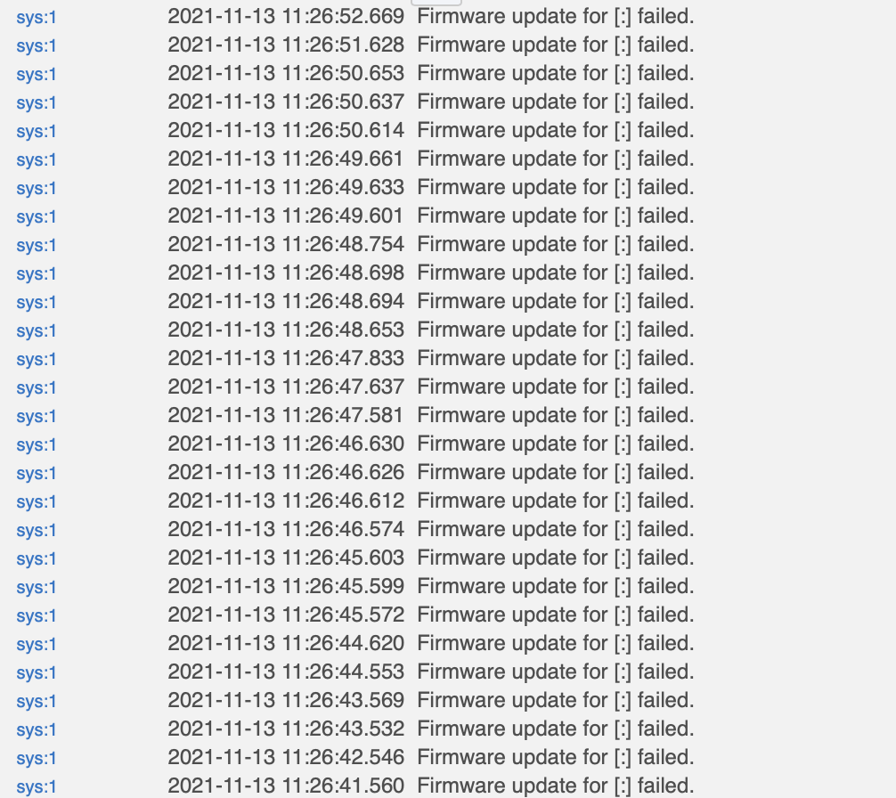

Im getting a lot of these. Ive power cycled the hub with shutdown, unplug, wait, re-plug procedure. Still getting them. I remember trying the Update Firmware button on a couple of Zigbee devices, which I think failed as there was no new firmware.
Perhaps that tempting button should only be shown or clickable if there is valid firmware for the device?
@mike.maxwell Any further tips to get it to stop trying?
Sure, bounce the hub that will stop them
Bounce meaning reboot, or power cycle? Or something else? Ive done both.
