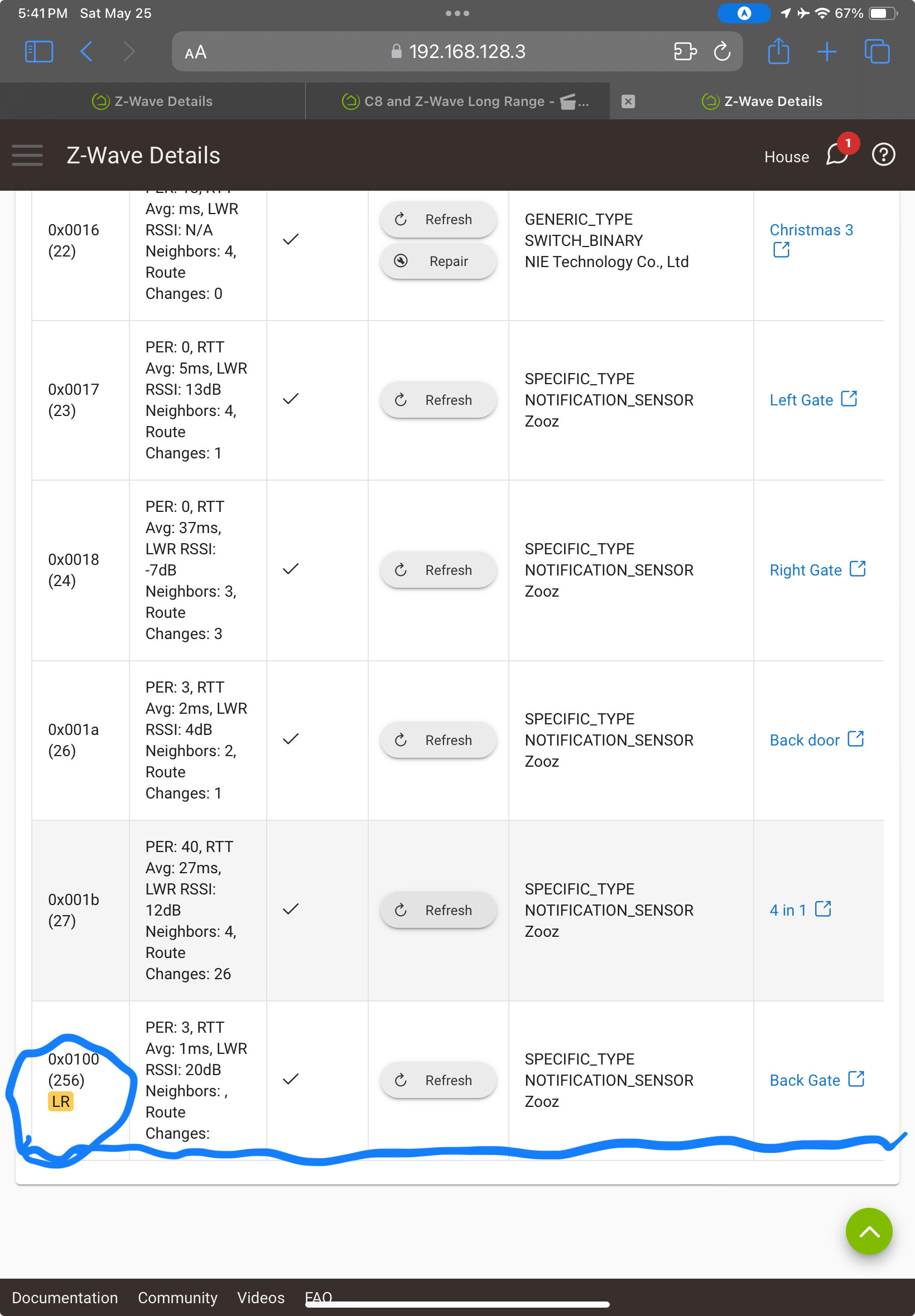

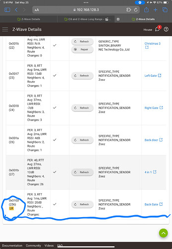

Zooz 800 series open close sensor Long range. I also upgraded the firmware on the C8 hub to version 2.3.9 and installed Smartstart. I registered the device when it was close to the hub and it successfully connected. When I install the sensor at the location I need it at which is above 150 feet away from the hub. It does not register any traffic or log anything from that node. In the device listing it has the yellow LR icon which tells me it registered as long range. But does not seem to be working. Did I miss something or do I need to get a zwave repeater to fill in the gap?
