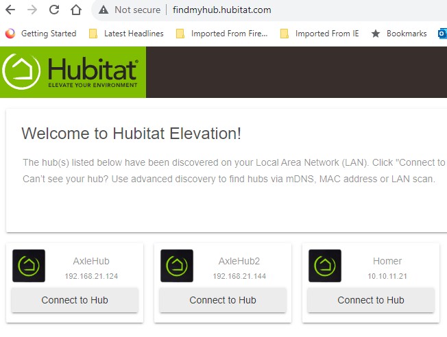

When I hit the URL "FindMyHub.hubitat.com" it not only shows my two Elevation hubs, but a third IP address, 10.10.11.21, that is nothing on my LAN. I'm guessing it's related to my ISP's network, and have sent them this same inquiry. Here is a screenshot of what comes up:
Screenshot 2023-11-27 213306

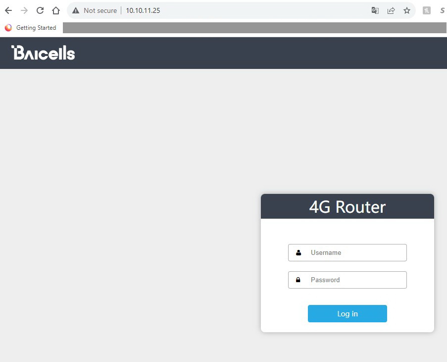

And when I click on "Connect to Hub" for "Homer", this comes up:
(There are actually several such hosts at multiple IP addresses in the range 10.10.11.21 to 10.10.11.27; this screenshot is from the one at 10.10.11.25, but it's the same thing at 10.10.11.21).
What I'm especially curious about is what causes this device (it looks like CPE, but I'm not sure) to get found by Hubitat, thinking it's an Elevation hub?

Homer is the unknown host on my network. My two Elevation hubs are named AxleHub and AxleHub2.

@rlithgow1 : Thanks for the tip; I installed Advanced Port Scanner and am running it now, looking in the range of 10.10.10.1 to 10.10.11.254. Within this range it has found 288 hosts, most of whom have ports 80 and/or 443 (http & https) open. For the ones I've checked, it shows their Details attribute as "4G LTE WiFi Router"; also some show "lighttpd 1.4.29".
I've learned that the 10.xxx.xxx.xxx subnet is reserved for private addresses, so I'm wondering whether these are all routers on my ISP's subnet?? I've sent an inquiry to my ISP's tech support, and will report back what they tell me.

Looks like you have the same public IP as Homer's owner, so find.hubitat.com is bringing in all the hubs it has found sharing the same IP. It's rare that this happens, but I have seen that before. As you can see, you cannot access the other hub and neither can Homer access your hubs.
That is an ugly and "potentially" insecure issue on his home network.

Hello Peter, From the Network engineer: Those are both LTE CPEs that broadcast a WiFi signal from neighbors. It's just like seeing the neighbor's SSID from their routers.
