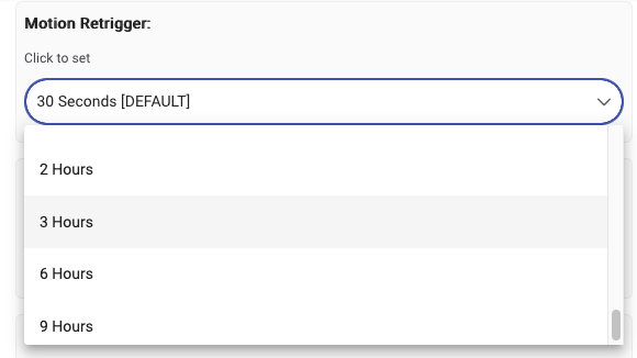

What driver are you using? Mine does not max out at 30 seconds:
Screenshot of "Motion Retrigger" options going up to 9 hours
But from the manual you provided, this does indeed seem like the correct option (though with a mysteriously different range, but one not capped at 30 seconds regardless).
"Fibaro Motion Sensor ZW5", the one Hubitat chose.
That is the one I'm looking at, too. Are you sure you don't just need to scroll down in the list to show additional values? Can you share a screenshot of what you're seeing?
