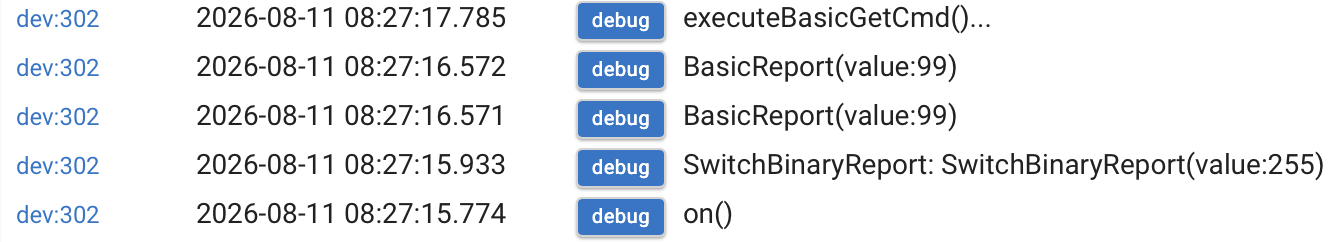

The device turns on/off via command. However when turning on, the state momentarily changes to 'on' before immediately returning to 'off'. This obviously messes up dashboards with wrong state and affects rules (cannot use from dashboard - only driver command panel). There's nothing obvious in debug logs. Output from command on:
It'll update power immediately. I have to send a 'refresh' to update the switch state.
