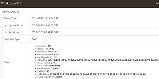

What firmware version are yours, are they definitely the Z Wave plus models? ( you can find this in the device page in the Device Details > Data panel at the bottom as shown below:
