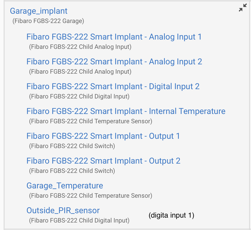

I had two of the older "non plus" z-wave units (assuming the "FGS-221" is the older version of the "FGS-222") that i couldnt get to work with hubitat. Appeared working one minute and the next it went awol.
Bit the bullet and upgraded to the newer FGS-222 z-wave PLUS units and (so far) all works well. Seems that was the only option.
It will show up with some extra child ins/outs that seem to be of no use but once you identify which are the "useful" ins and outs you can rebuild your system.
With mine i have two inputs and two outputs, of which i'm only using one of each
i have a DBxxx temperature sensor connected. Guess the analog inputs are used if the unit is configured as such, therefore making the digital inputs redundant, i guess?
Similarly, i've not found the "internal temperature " to produce anything meaningful- perhaps this requires an additional sensor also.

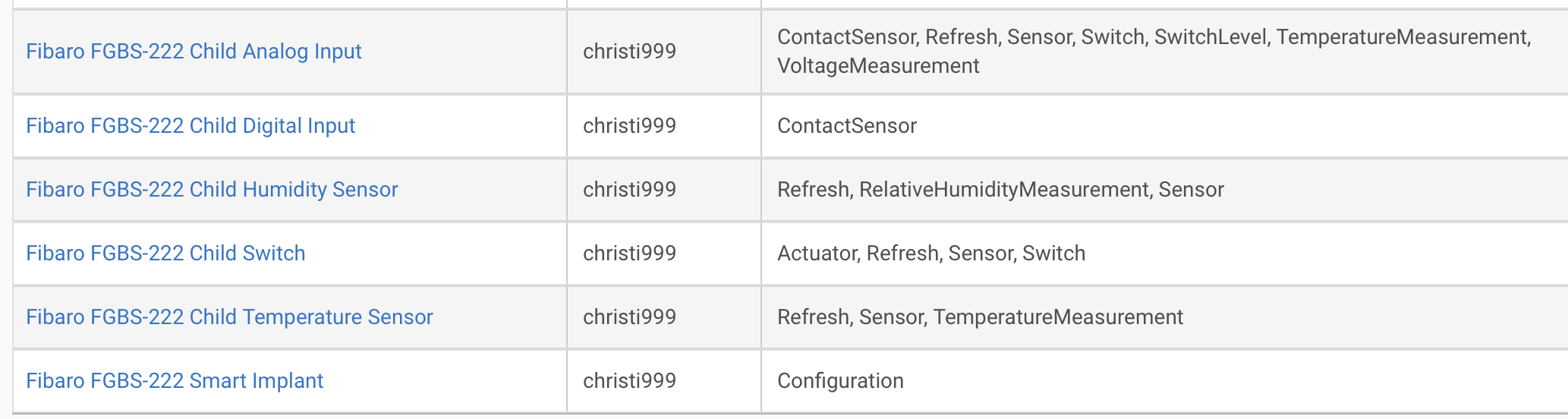

follow up-
i had to install download and install a custom driver (you may already know this or have done this) I dont, however, recall if i installed one driver that created the other instances or if i had to install them all separately, but they appear in the "drivers code" section lke this:
