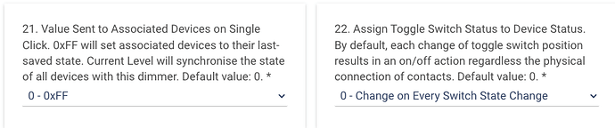

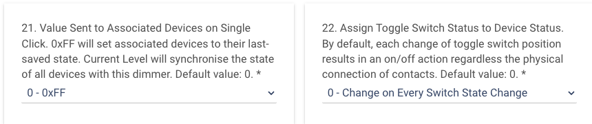

and 21 to 0? I do not see that listed. Else I don't know other than a factory reset and try again.
It's zero. Thanks for these hints, I'll probably do a factory reset. Btw, running this device in a secure mode, but it shouldn't matter (?)

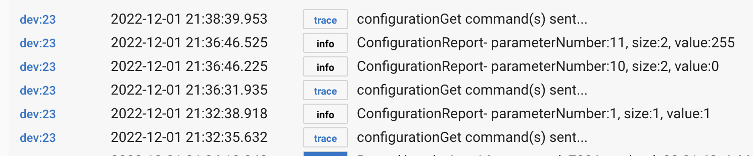

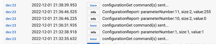

I changed to Basic Z-wave tool and ran "Get parameter report". At first I thought it doesn't work, but it's just very sloooow:
EDIT: it's not slow, but just gives a couple of parameters (although the whole list was requested)
Using Basic Z-wave tool and setting parameter 13 to do forced auto-calibration finally did the trick. Now I'm back with Robin's version of the driver.
