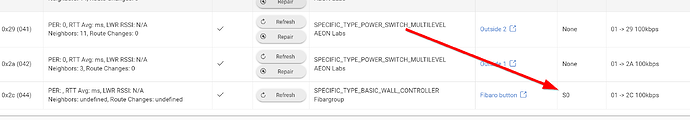

all my repeaters devices are aeotec dimmers. And they are security type None.
the fibaro button is added with security S0.
how do i disable it? i dont see the option to disable when i first pair the device. Any ideas?
Add it using a secondary controller.
Although, frankly, having a single FLiRS device paired as S0 isnβt going to have a dramatic negative effect on your zwave mesh.
I would just leave it. Its just a button so it wont be high traffic. I also have a Yale Lock that is S0 and no issues with it. The main issue with S0 comes into play if it is high traffic, like a sensor or power meter device.
yea overall works just fine. Might just leave it.
curious how to do this?
Depends on what you use as a secondary controller. But basically ....
I use an Aeotec Minimote as a secondary controller.
I had the same issue. I used a UZB stick to remove the SO security then after that it pairs with hubitat without security. I'm not buying any Fibaro products anymore because of this.
