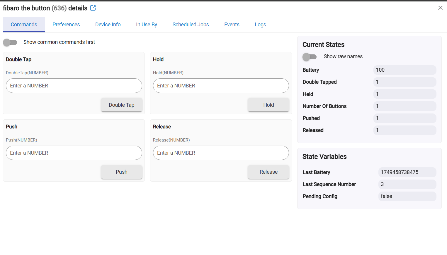

Fibaro button doesn't have refresh option, battery levels are incorrect
to use fibaro button, have to use "generic zwave button" driver.
it doesn't have the option to manually refresh the device. If it did, i could have made a rule to refresh it daily.
Because of that, my device just died after a while due to flat battery. HE still shows 100% battery. I kept wondering whats wrong. Only when i tested the battery did i realise its just dead.
I had made a audio broadcast for all my battery devices. If the battery levels fall below 15%, i get a audio alert. Sucks that due to incorrect reports of the fibaro button, i couldn't replace the battery earlier.
Anyone else had this issue? im prepared to replace this zwave fibaro button for something else if i have to. I need proper battery reports.

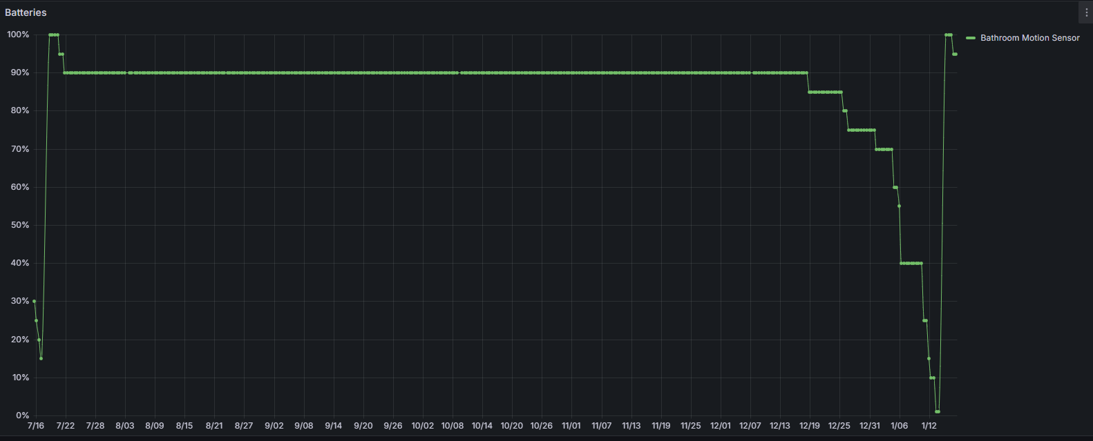

Here is some devices using the CR123A
This one only uses one battery, you can see it holds at 90% for most of its life then drops off and dies within a month at the end. This is how Lithium usually works.

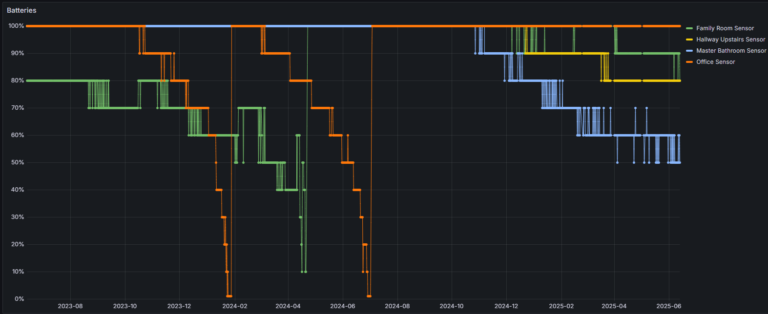

These all use 2x CR123A (they are all Zooz ZSE40).

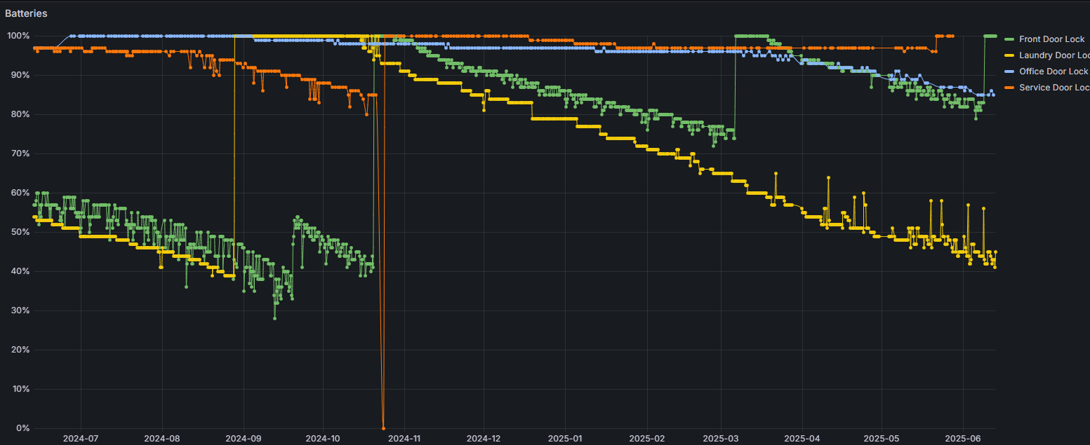

Here are my locks using AA Alkaline batteries, you can see they are more of a slow and steady decline. The front door just stopped working right last week and it was only at 80% so I never know when its going to stop working actually, again, very inconsistent. I really need to find some good inexpensive lithium AA to use in these, the voltage will hold longer so they will last longer.

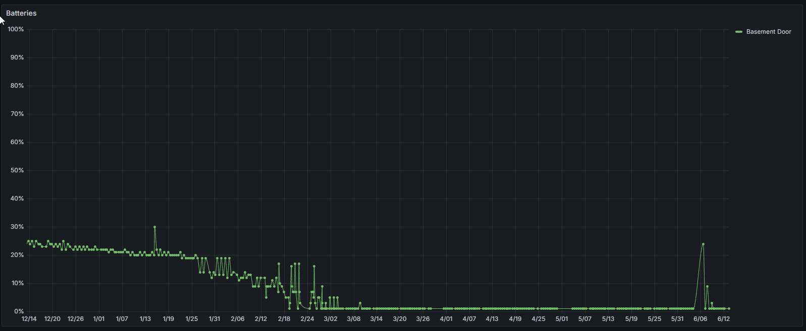

Its sort of normal with the Zooz devices that use the CR button batteries. Here is my ZSE41 contact sensor. The small uptick is when it finally died and I put another used battery in it. Was running showing 1% for 3 months. This thing seems to run on the weakest batteries so I feed it all my almost dead ones to finish them off.
You are the graphmaster!
