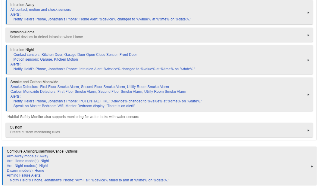

  2. I can't figure out why when using HSA, and having modes auto-arm, the auto arm isn't working (see screenshot), please ignore my generic alert text. I'm just building stuff right now.
