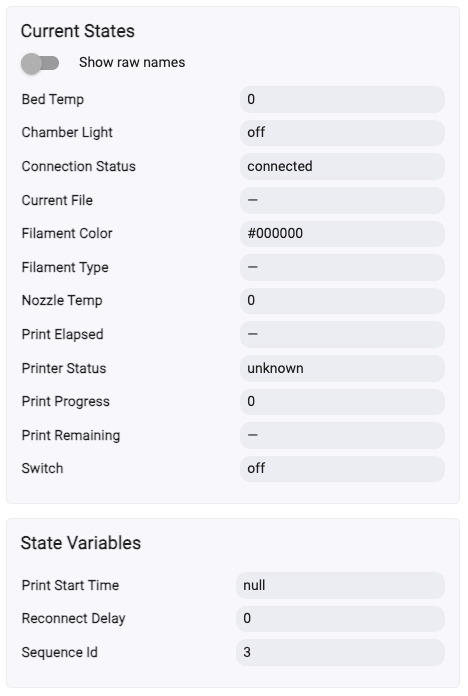

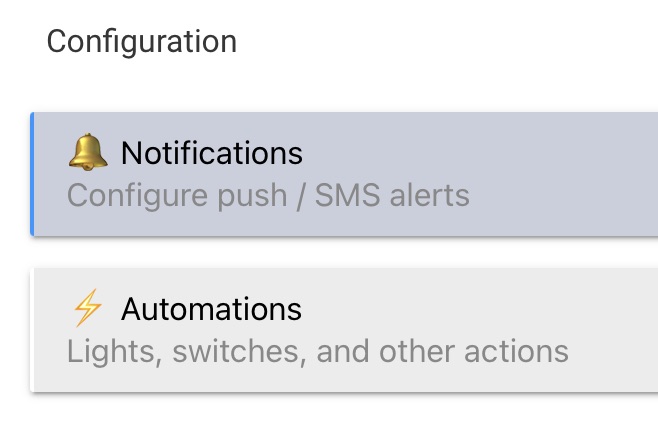

Here are some images of what you can expect to see in the driver and app

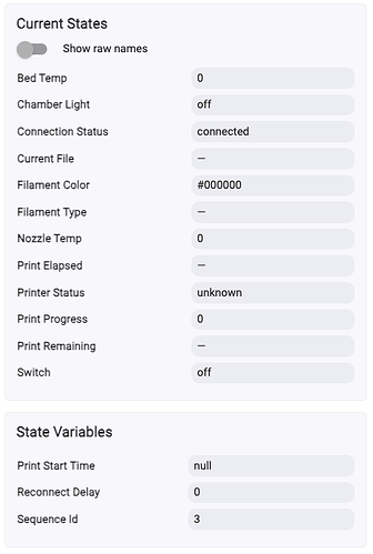

Unfortunately, I'm not having any luck with this one. Everything installs fine, and I can control and see the status of the chamber light, so I know the connection is there. But it always lists the print status as unknown.
I should note, I do have this printer set up on Home Assistant, and working perfectly in Hubitat via HADB, but I was hoping to avoid the 2-hop with your thing here. It occurred to me that Home Assistant could be causing MQQT connection issues, but disabling that integration has no effect.
(This is in the middle of a print)

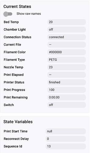

I merged this as it seems well written. It fixed some of the issues but created some new ones, which is pretty normal :slight_smile: I am getting MQTT responses now, the same ones I was getting manually via paho which is v promising.
There's an unexpected end of array error when parsing them, which is probably easily fixed with some error handling when the stream closes. But I have lost control of the chamber light somewhere in this process - need to troubleshoot that
