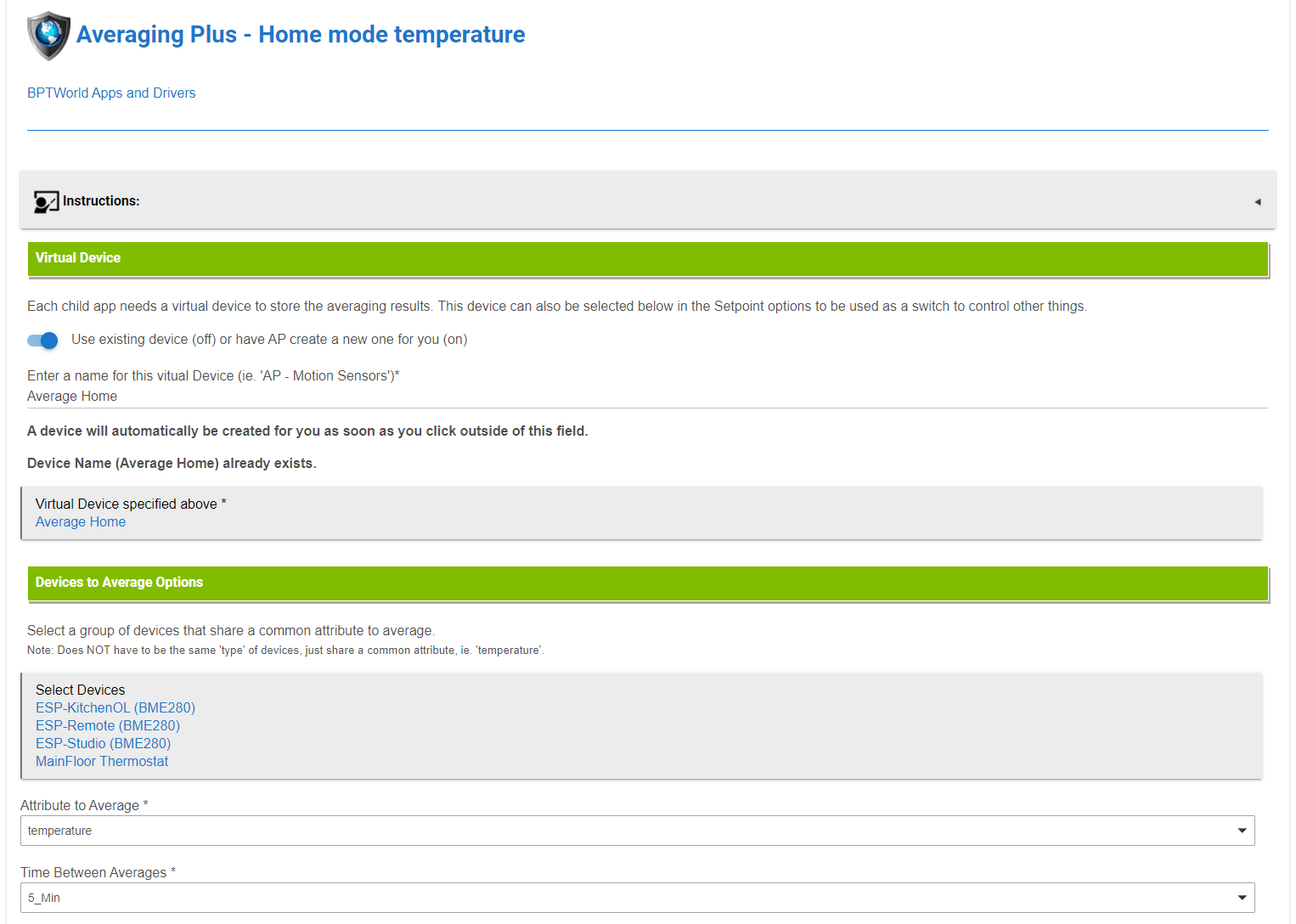

Created a placeholder virtual temperature sensor:
Then used the outstanding AveragingPlus by our one and only @bptworld in conjuction with his flawless driver implementation for the t6 Pro:
Created a child averaging automation with my required remote temperature sensors per mode:
Used RM to dynamically adjust the targeted averages profiles and pass on the value to the sensor place holder while selecting correct averaging profile depending on the mode:
Set up the vThermostat controller with the virtual temperature placeholder:
Then setup the Scheduler to manually control my tstat by modes:
And to scale out with other profiles, rinse and repeat.
See @SmartHomePrimer, that wasn't that bad.
Now I can tamper down my tantrums and ever changing mood swings
This system in my world is able to cope with all the manual changes I want and works as a truly smart tstat. I didn't even had the need for a janky, convoluted setup as you suggested.
BTW @bptworld beer is on me this weekend:
