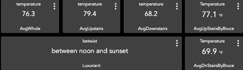

Bruce created an averaging App, using another method:
I have both on my Hub and for my purposes they are similar enough:
Screenshot 2025-02-22 at 12.33.29 PM
(gnore the "between noon and sunset tile" but you can see the 5 averaging instances I have deployed. AvgWhole, AvgUpstairs, AvgDownstairs are all using my Average This App while the "byBruce" tiles are using his. They are almost never the same but they track against each other in a similar way of the day.
