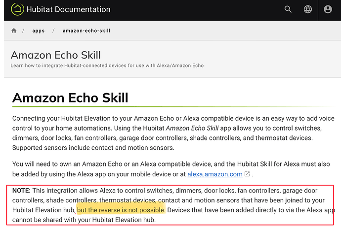

The Amazon Echo App only exposes Hubitat devices to Alexa, it doesn't pull in Alexa devices to Hubitat. That is why so many people have various methods of controlling Alexa devices from Hubitat, like using a virtual contact sensor and an Alexa Routine.
That is 100% the expected behavior. Alexa-connected smart home devices cannot be shared with Hubitat via the Hubitat Amazon Alexa Skill. As previously mentioned, the built-in Hubitat Amazon Echo Skill integration allows for one-way sharing of devices, from Hubitat to Amazon Alexa.
From the Hubitat Documentation
You sure its Zigbee? You cannot pair a zigbee device directly to a mobile app, unless you also have a separate Zigbee hub? It sounds like a Wifi device you added to your Wifi via the mobile app?
If it is Zigbee, you should reset it and pair it directly to Hubitat.
