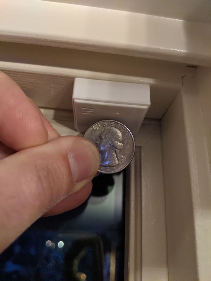

Nyce NCZ-3011 are very small Zigbee door/window sensors. Long battery life. Not inexpensive.
