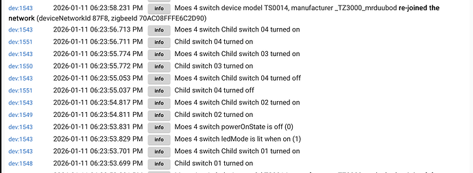

The problem is that when I turn on the third any three switches, the device makes a fairly loud click sound, all switches turn off, and the loses it pairing. Usually it “magically” re-pairs itself but often requires me to use “add device” to re-pair it.
Sometimes turning on third will not cause, but fourth always will.

Seems driver independent. Both Generic and Zemismart drivers respond the same.
No loads on the switch only power (“L”) and neutral (white wire) connected.
Also it sometimes just “locks up” and I have to remove power to get it to work again.
