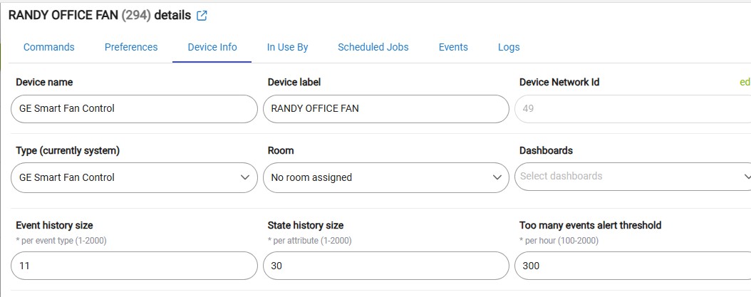

I curtly have the GE fan switch
Device Details
Create Time 5/11/2026 11:47:51 am
Last Update Time 5/11/2026 12:04:13 pm
Last Activity At 7/02/2026 11:55:01 am
Controller Type ZWV
Device Data
Show raw names
Device Id 12600
Device Type 18756
In Clusters 0x5E,0x86,0x72,0x5A,0x85,0x59,0x73,0x26,0x27,0x70,0x56,0x2C,0x2B,0x7A
Manufacturer 99
Zw Node Info D3 9C 00 04 11 08 5E 86 72 5A 85 5C 59 73 26 27 70 56 2C 2B 7A 68 23
It is a pain to change the fan speed with this switch. If I bought the Zooz 800 Series Z-Wave Long Range Scene Controller Switch ZEN32 800LR. Is it possible to program the buttons for Low, Med and High? Looking for a switch with just a push of a button I can change the speed.
