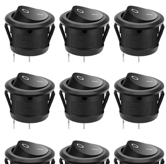

Hard wire them on and up inside the canopy add in some small 120vac UL approved switches, such as these:
They come in other shapes...
32%20PM
I did this on all my fans... I just have to drop the canopy down onto the fan blades and toggle the switch. Since doing this, Murphy's Law has prevailed and so far, I've never needed it!!
I added a pair of 4" wire to each switch and put on some heat shrink tubing. Then I climbed up to the ceiling and wire nut them in place.
