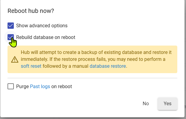

For giggles and to eliminate a couple of potential issues, do a reboot with a database repair. After that shut down the hub and physically unplug your hubitat from power for 1 minute (this ensure the radio databases are cleared in case the running ones are corrupt, which does happen sometimes). Once everything is brought up, look at z-wave details and ensure there are no ghosts. Once that's done try the switch to JS again.
I seem to be moved over to Zwave JS without any major issues. It took a day or so and a reboot to get most the devices out of pending but I seem to be okay now. Should I still go ahead with a repair? I had one Zombie/Ghost after the switch but was able to remove it.
rebuilding the database can never hurt
