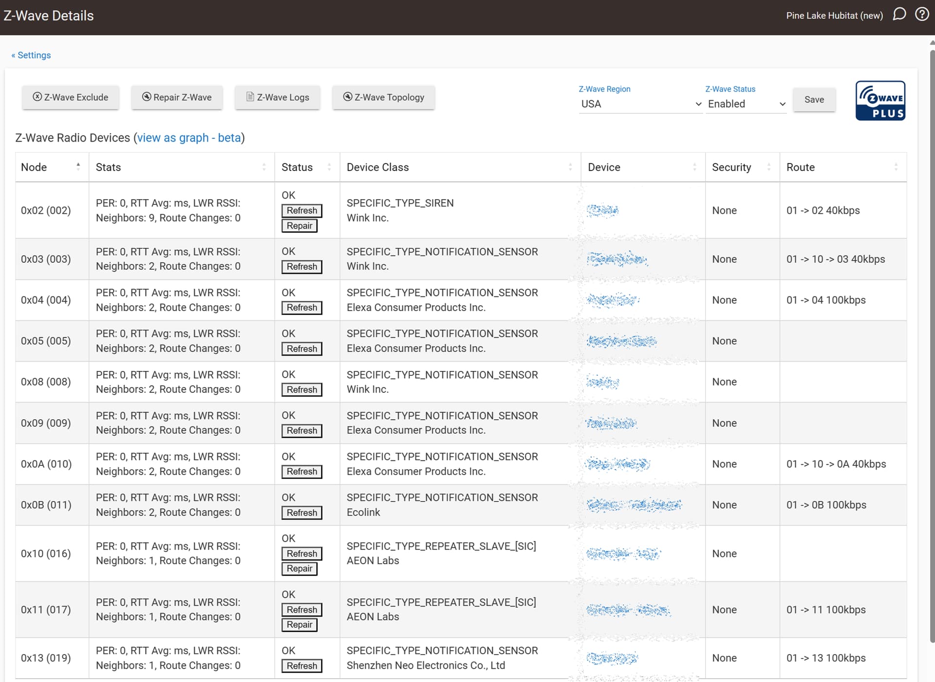

Post your z-wave details page. Hopefully your c5 didn't have ghosts that migrated.
Screenshot or is there a way to download it?
Screenshot, use windows snip. Post the entire z-wave details page :slight_smile:
Here you are. Doesn't appear to be anything out of the ordinary from what I can tell.

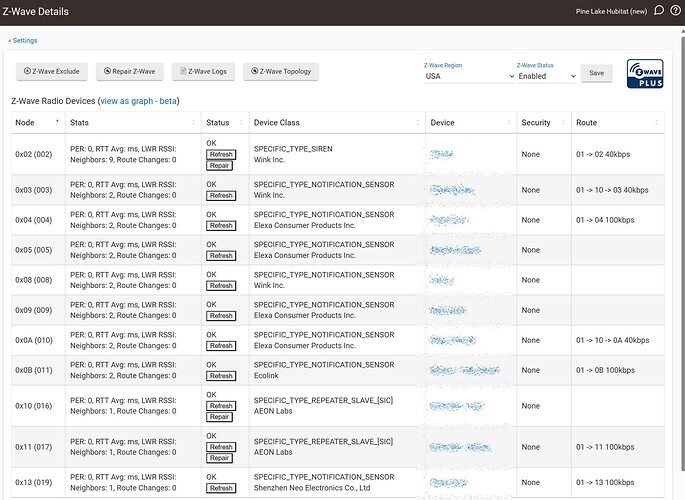

0x10 (016) appears to be a problem. It's got the Repair button, so it's not a battery device like the other three. No Route on a line powered device is a sign that it needs investigation. First, are you able to control it or is it sending status?
thanks for pointing that out. It must have not completed finding the devices when I took the screenshot, they all have values in the Route column now, with one exception but I know that device is currently off-line. I have been testing for the past couple of hours and all is good from what I've seen so far.
Is that battery or a mains powered device? Otherwise it looks good!
Not healthy
