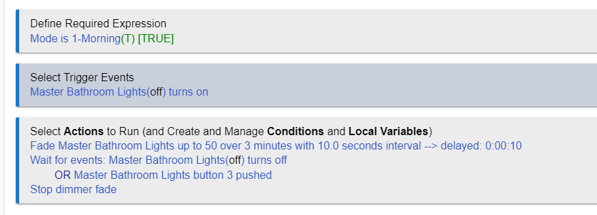

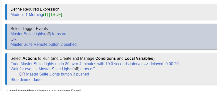

The only way I found to do it was to have a separate RM for just the fade up. The wait for events and the stop dimmer fade ensures that if someone turns off the light it cancels the fade up (so it does not turn it back on and continue the fade).

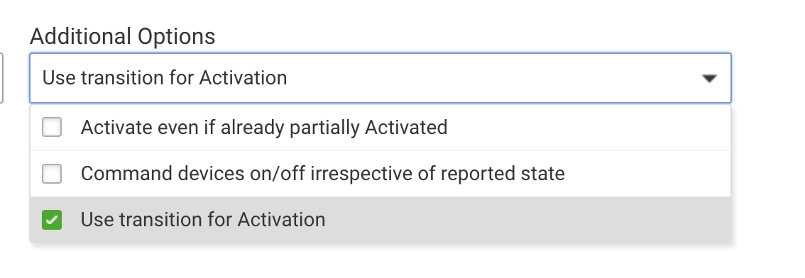

If I’m understanding what you want, this can be done in Room Lighting.
When motion is detected, the lights ramp up to 100% (or whatever value you specify) over the specified time in seconds:

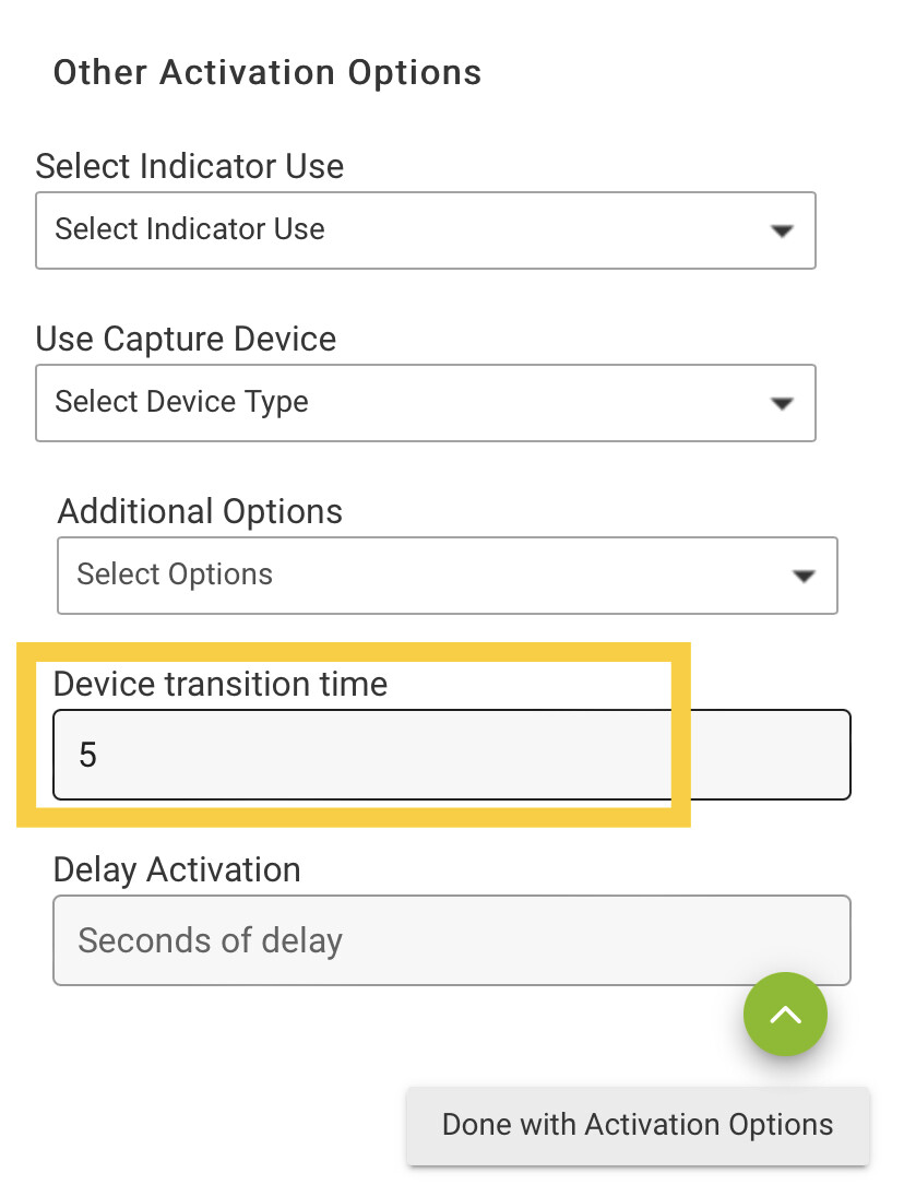

Just go to the device page, turn it off, then do a setLevel to 100 with duration of 600, see if it works. Thats the command that RL would send if you set that transition time to 600.
I don't know what the maximum fade time for Caséta is. RM does have raise dimmer over time that uses individual setLevel commands spread over time with an interval specified. Room Lights can also do this. One thing you can do when using this is set the device fade to the interval time, and you end up with a very smooth transition.

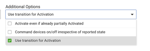

Can Room Lights do it as a fade up? I was only able to figure it out for the preset off fade out.
Yes, it can do either a transition from A to B, or from current levels to B. The latter is a transition upon Activation.
@rlithgow1 sounds like this could replace my rule. I will have to check it out possibly tomorrow. May not work per mode though which I will need my rule for still to limit it to morning only.
