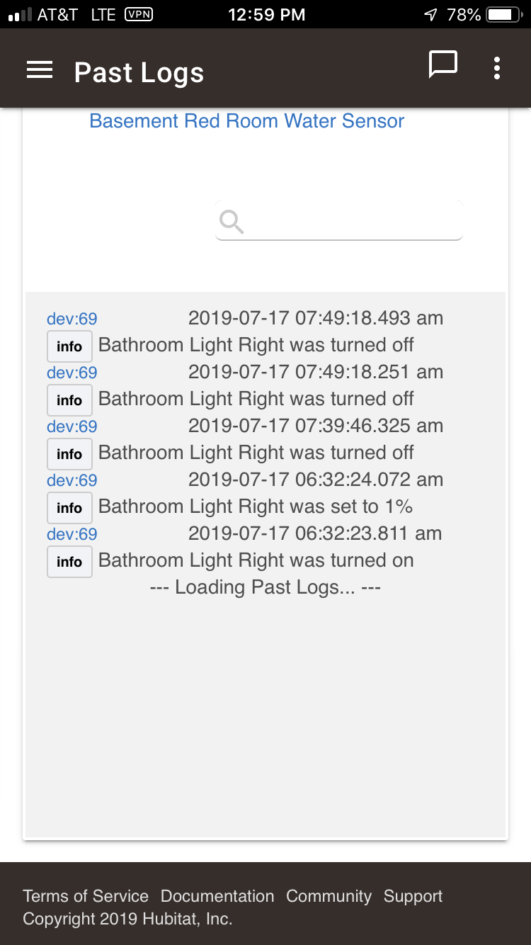

I’m traveling right now and for the next few days but here is as much of the info as I can get as you requested. I’ll turn on logging of the rule when I get home in a few days.

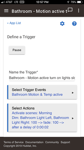

Background of this rule:
If I enter my bathroom before 8a I want the lights to come on at 1% brightness and increase to 100% brightness over 100 seconds for a slow wake up in the morning.

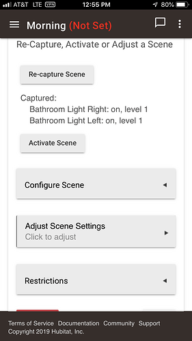

I have a scene called ā€˜morning’ that turns the lights in the bathroom on at 1% (created so I can easily turn on the lights manually at 1% if my motion sensor doesn’t activate or if I want to turn the lights on before I get in there)
The ā€˜disable if left light is on’ was to stop the lights from continually dimming back to 1% every time the sensor was triggered. There are probably easier and better ways to write this rule but it was working great and I didn’t have to mess with it after it was set up.

Screenshots as requested
