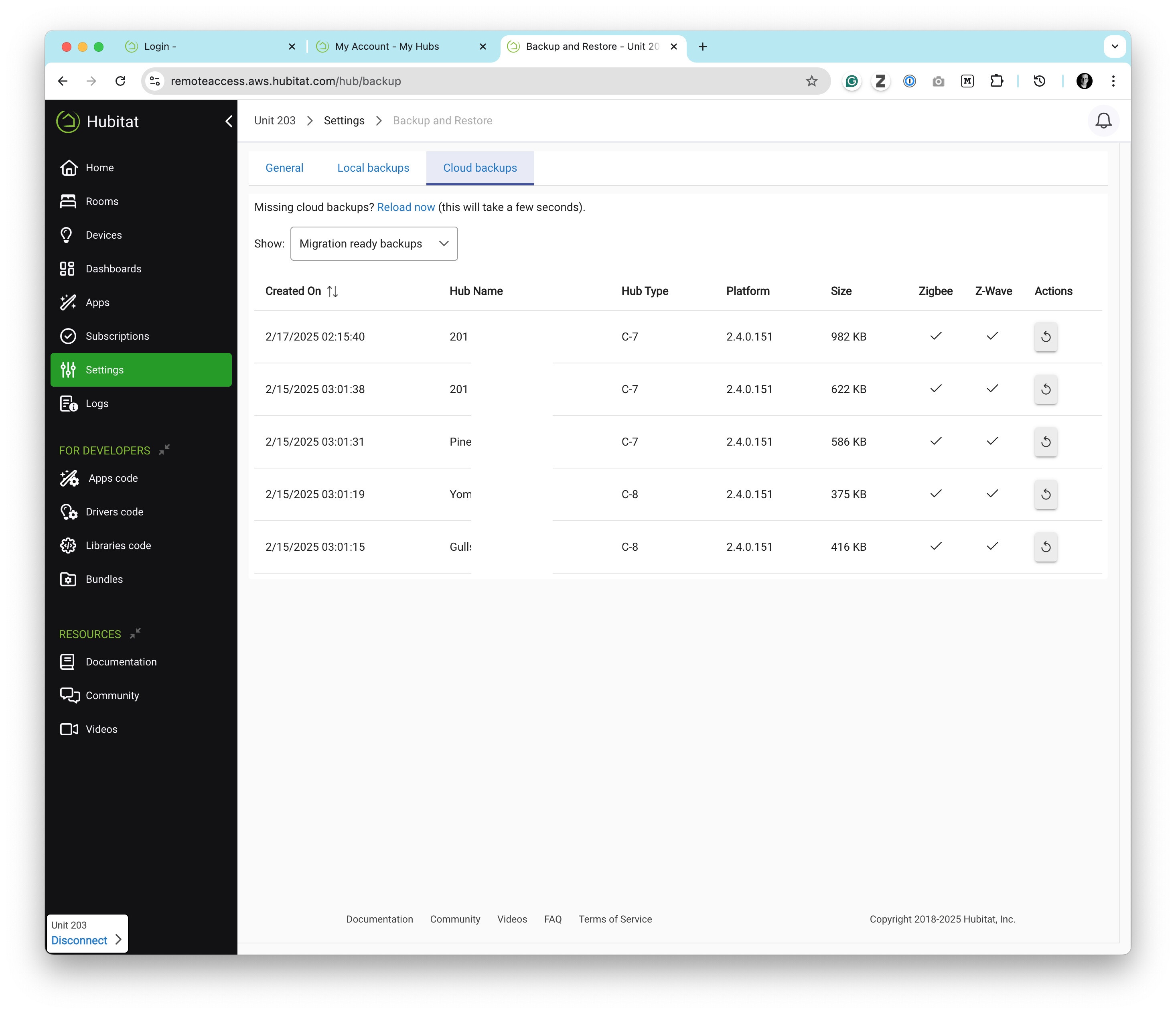

Here is the screen showing successful backup:
And here is the tab showing the cloud backups. We have a lot of Hubitats, but note that the Unit 203 backup is not present:

Also, do you have any clue why the backups made ot the cloud are not showing up as "cloud backups" ?
They will only show up if you have a Hub Protect subscription on that hub. Otherwise, it's a one-off backup that can be used for migration.

Possible issues:
  1. You may have actually made a local backup
  2. You have to be logged into your HE account on the new hub (C8) to see the cloud backups made from the C7
If you persist on not seeing the C7 backup, create a new cloud or migration backup.
