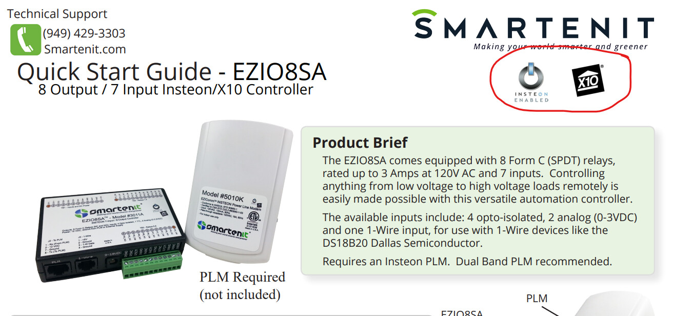

Does the Hubitat support the Smartenit EZIO8SA? If not what low voltage multiple input controller are you using?
My educated guess is "No, Hubitat does not offer built-in support for this device." It appears to be Insteon/X10 compatible, not Zigbee or Z-Wave.
