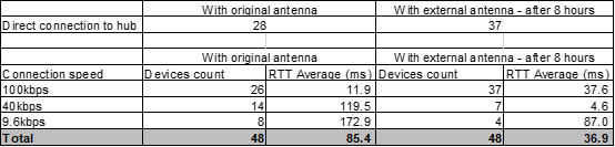

Hi guys,
I am sharing my expirience as someine might find it useful.
Special thanks to @lewis.heidrick for advising and supporting.
8 hours after installing the external antenna this is where I am at (I know it should even be better in a couple of days).
This is my setup:
  • My house is a 250 Sqm facility, 3 levels, made of (mainly) concrtete walls, full and heavy wooden doors, big glass windows with aluminum roller shades covering most of them.
  • 48 Z-wave devices, most of them Fibaro (double swich, double relay and roller shutters), 6 Aeotech range extender 7, and some NeoCoolcam motion sensors and plugs.
  • All but 3 devices are sitting inside the house and 3 are located about 5 meters from the outside walls.
  • Replaced the original antenna with a 3dbi 868Mhz (EU Z-wave) antenna
  • Took away the zigbee original antenna (I do not think this is important buy it happened).
  • Nothing else was changed, including hub location, devices, etc...
  • Ran a full z-wave repair once and 3 specific repair for 3 devices.
Highlights after 8 hours:
Lookin' good! It can take a while for some devices to let go of their old routes but give it some time and it'll eventually clean up. If you're impatient you can trip the circuit breaker for whatever devices you want to reset for about a minute and see if it will find its way back to the hub.
I noticed mine cleaned up itself from nearest to farthest from the hub as they direct connected, further devices started lookin to see what was goin on.
