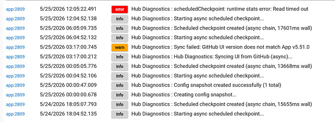

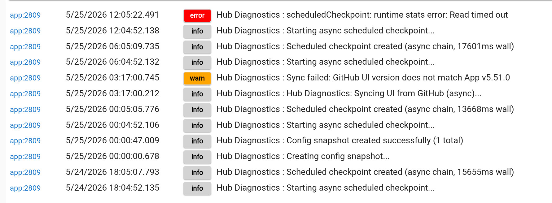

The Checkpoints (every 6 hrs) and Snapshots (daily) mostly worked great. Got a couple errors.

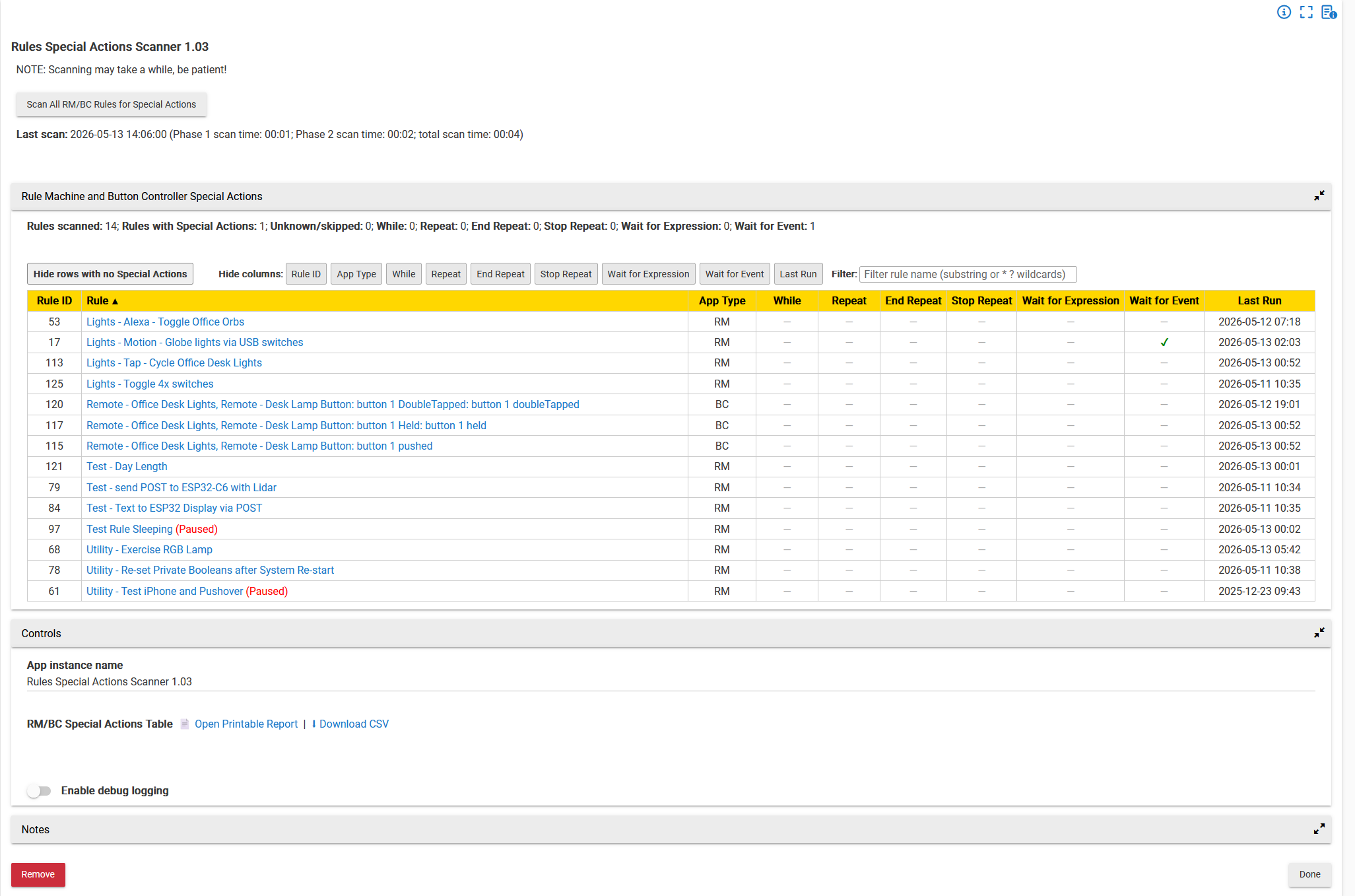

This app scrapes the metadata of Rule Machine and Button Controller rules and reports on the presence, absence, or non-detected state of the following actions within all rules:
While
Repeat
End Repeat [count should match Repeat count, but a mismatch indicates a mis-coded rule]
Stop Repeat
Wait for Expression
Wait for Event
[Screenshot_Rules_Special_Actions_Scanner]
The conditional actions noted above have sometimes given me fits, and when I learn a thing or two in one rule about better appr…
Thank you for the kind offer, but I think your apps are pretty awesome as-is as for-purpose tools.
The Hub Diagnostics app is absolutely huge already and it probably would be wise to cut scope, not add to it at this point.
JimB:
There is a 30-second timeout on some of the heavier fetches (checkpoints need to load the full past logs to get the app and device stats), looks like one failed. I'll add a one-time pause-and-retry. Take care that Hub Diagnostics is not overloading the hub.

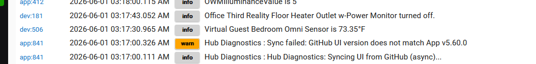

I received this log message early this AM, I think the first of it’s kind I’ve seen. Is it of any concern?
Not of any particular concern, but the latest version is 5.65.3, just use the “import” function in the code window (linked directly from the app’s config page).
