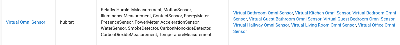

One of the challenges, I have encountered is that there are certain types of devices that I want to expose in a Hubitat Dashboard via Node Red to Hubitat (using Maker API) that the current set of Virtual Drivers, do not support entirely.
My research indicates that Virtual Devices are the solution I am looking for. The native virtual device drivers are exactly what I need when they cover all of the device's capabilities, but don't support all cases.
Are there others that like to have a broader range of virtual devices? I see in Hubitat Package Manager that sab0276 has created a "Universal Virtual Device Switch" which covers even more variables that the Virtual Omni Switch, but I am imagining creating more specific virtual devices that only have the relevant capabilities.

What I am not clear on is what you need the virtual switches to do, that the current ones are not doing for you. I code all my automations into custom apps and virtual drivers, to make them do what I need them to. What specifically do you need added to any current built-in virtual drivers?
I have found that my reliance on HE stock drivers which are not public causes a lot of problems since I can't look deeper - I used the UVDH (Universal Virtual Device Switch) and modded it to my needs.
I would love to see A virtual motion sensor, that allows the ability to force the active/inactive state, and a few others if I'm understanding what your suggesting... I will watch closely!
I tend to use the virtual devices as a way to put a devices data on to a hubitat dashboard. So if I have a device like an inovelli presence switch which is like a dimmer, but also has display LEDs and has mmwave presence detection, the existing virtual devices would require me to fan all of those capabilities out to multiple devices. I recognize, that with the right hubitat, these innovelli switches could be paired directly to the hubitat, but that isn't a great fit for my circumstance, but I still want to see the device in my Hubitat dashboard.
