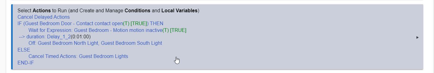

I do that in several places in RM. Here is one example:

Wait for Expression with Duration is the and stays for for conditions.
I can post the rule, but it's incomplete. Here is what I'm trying to do: If there isn't any motion and a switch doesn't come one then run the action. Maybe I'm wrong, but I didn't think the Wait for Expression would work with two different types of actions (motion and a switch).

No, timeout is different from duration. You want duration to get Stays in the condition.
