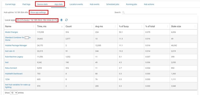

Go to Logs tab, and see if there are any warnings or errors in either current or history logs. Handle those first.
After that, go to App Stats in Device Stats in the Logs tab. Open the settings just above the statistics in both of those, and check all the options.
Those App Stats and Device Stats should tell you if something is chewing excessive processor time. In this example, my overall usage is very low at 3 minutes for a whole day of uptime. And my worst app is barely working the hub at all.
