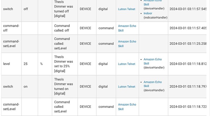

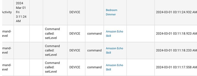

So, went about a month with no issues and this happened again last night at 3:15am ish. All of the lights came on bright.
I went to the "events" page of a couple of the devices that turned on (which is seemingly every device in the house) and it looks like something to do with Amazon Alexa.
I went into the Alexa App, but I'm not seeing a place to completely turn "Hunches" off if that indeed is the issue.

@BrandonT Yes looks like Alexa called the set level commands at 3:11. If hunches is off it should not be doing anything. You can just use voice command and tell Alexa to turn off hunches.
