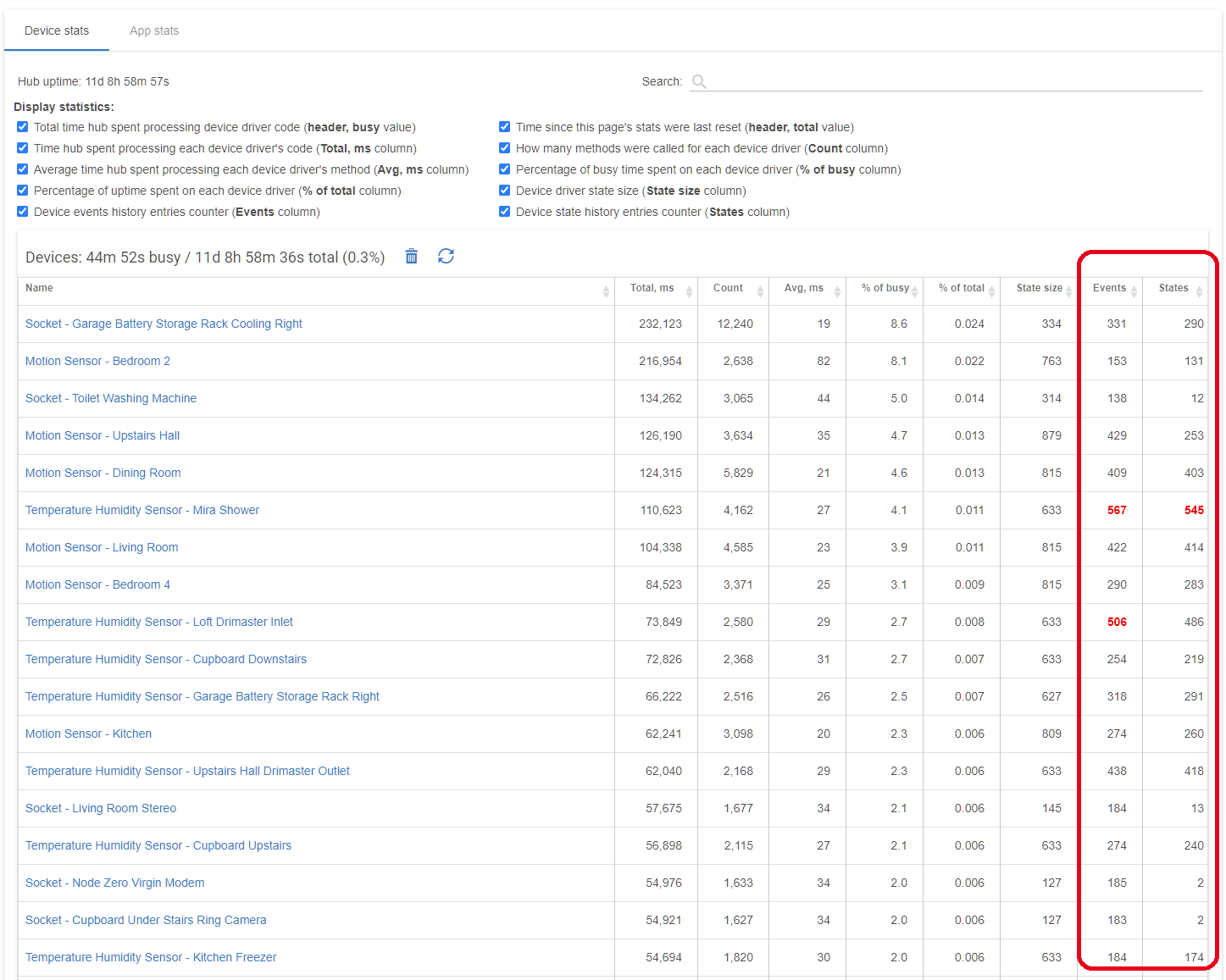

@gopher.ny I just noticed both my C4's running 2.2.7.126 don't appear to be respecting the event limits (not sure about states as it's difficult to check those).

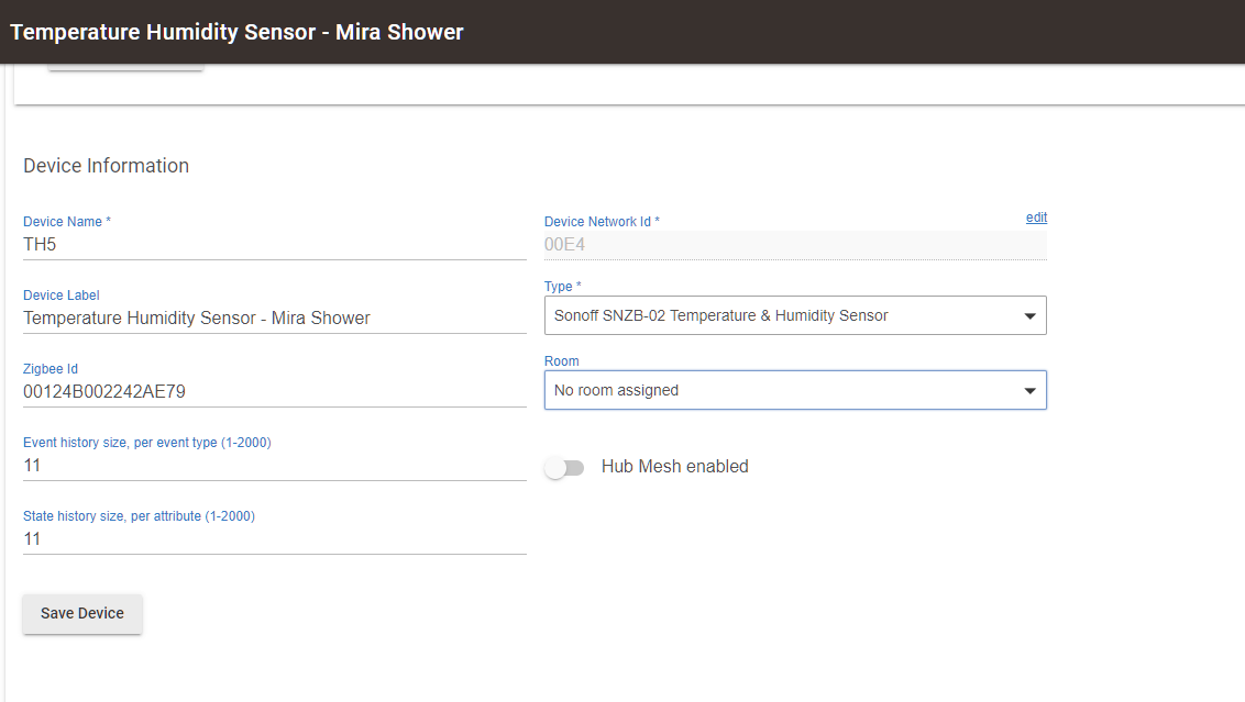

Event / State limit is set to 11 / 11 respectively.
A possible bug?
C4 runtime statistics:
One device:

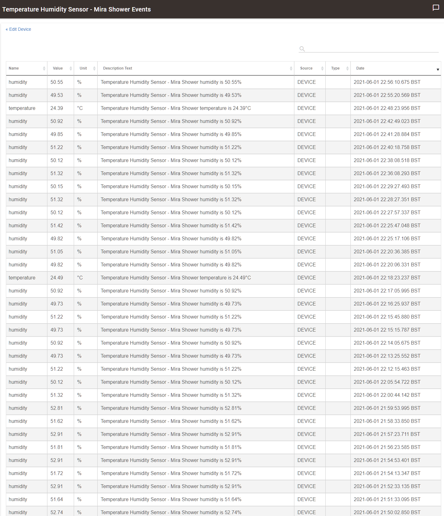

One device events page showing many humidity events .... way more than 11 (there' are a total of 567 entries which matches the total on the runtime statistics page)

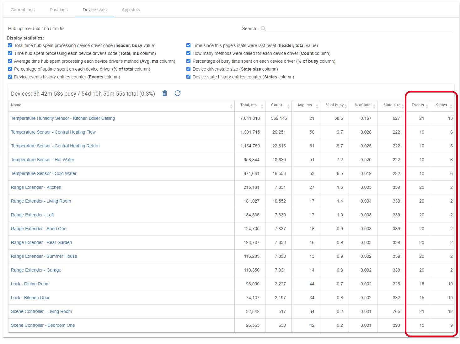

The other C4 is the same behaviour so I've not shown screenshots for that, however my C7 running 2.2.6.139 seems much closer to what I'd expect:
