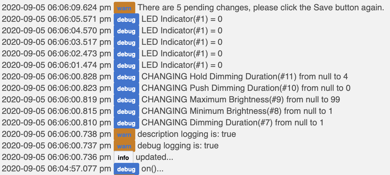

I appreciate the help. I had excluded it and rejoined it, but had not factory reset so I gave that a try and it seemed to get a bit further, but still stuck. It still recognized it as Device when it first joined and how I have more log entries, but it says "There are 5 pending changes, please click the Save button again" in the logs and I've clicked save device and save preferences a few times with no change. I'll let it linger in this state for a bit and see if something change in the communication unless anyone has any additional ideas. Thanks!
