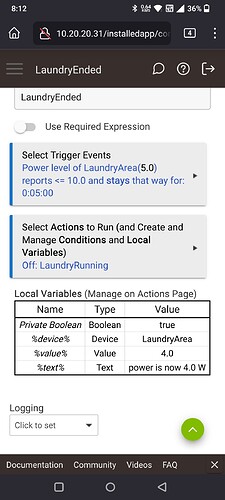

I'm on mobile so apologies for my formatting but this is the RM rule. It pops up with that error every few minutes on it's own.
The rule just turns off a virtual switch. The other rule turns it on when power is greater than whatever for xx minutes. No errors in that one though.
You could try re-creating the rule to see if the problem persists, which might help if the error is related to something from previous edits (other traces of which must be gone now, and if you can figure out what change caused it, it could probably be fixed). If it still happens, maybe there is something in their Rule app that atsffncokls look into.
Interesting. Both of the devices generating the errors did indeed have scheduled jobs. I know the outlet I deleted states but not the scheduled jobs. As for the contact sensor, it had the same 3 scheduled jobs as the outlet despite never changing it's driver. They are cleaned up now and the errors should stop.
I just hit update rule for now, if that doesn't fix it, I'll recreate it. Now that I'm a little more proficient with RM I could probably combine my two laundry on/off into one and get rid of the virtual switch with notifier. :slight_smile:
