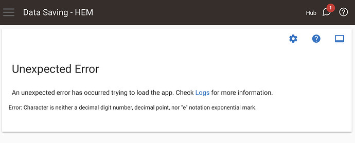

If I try to instead use a Sensor Value, I get an error as soon as I select the device from the ā€œEnergy meterā€ selection box (in the existing or in a new rule):
I’m at a loss as to why this Rule has stopped working. It has worked for me for at least a year (triggers every 30 minute) without fail. Suddenly however, it has stopped working.
I have tried a soft reset and restoring a backup from yesterday, but the problem persists. I am at a loss as to what to do next to try to resolve this… Will get back at it tomorrow, but would love to get input/recommendations…
Changing the driver to another one available from HPM seems to have resolved the issue.
