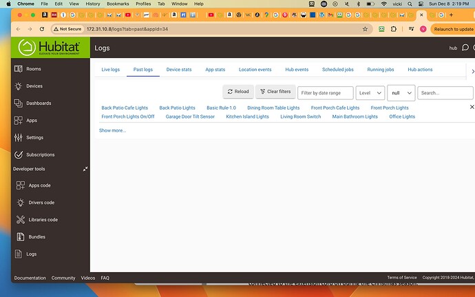

Tap “Clear Filters” then “Reload”
I'm guessing the rule in play here is "Front Porch Lights On/Off" - can you post a screenshot of that rule (not the logs)? How that rule's been constructed may have important clues.
