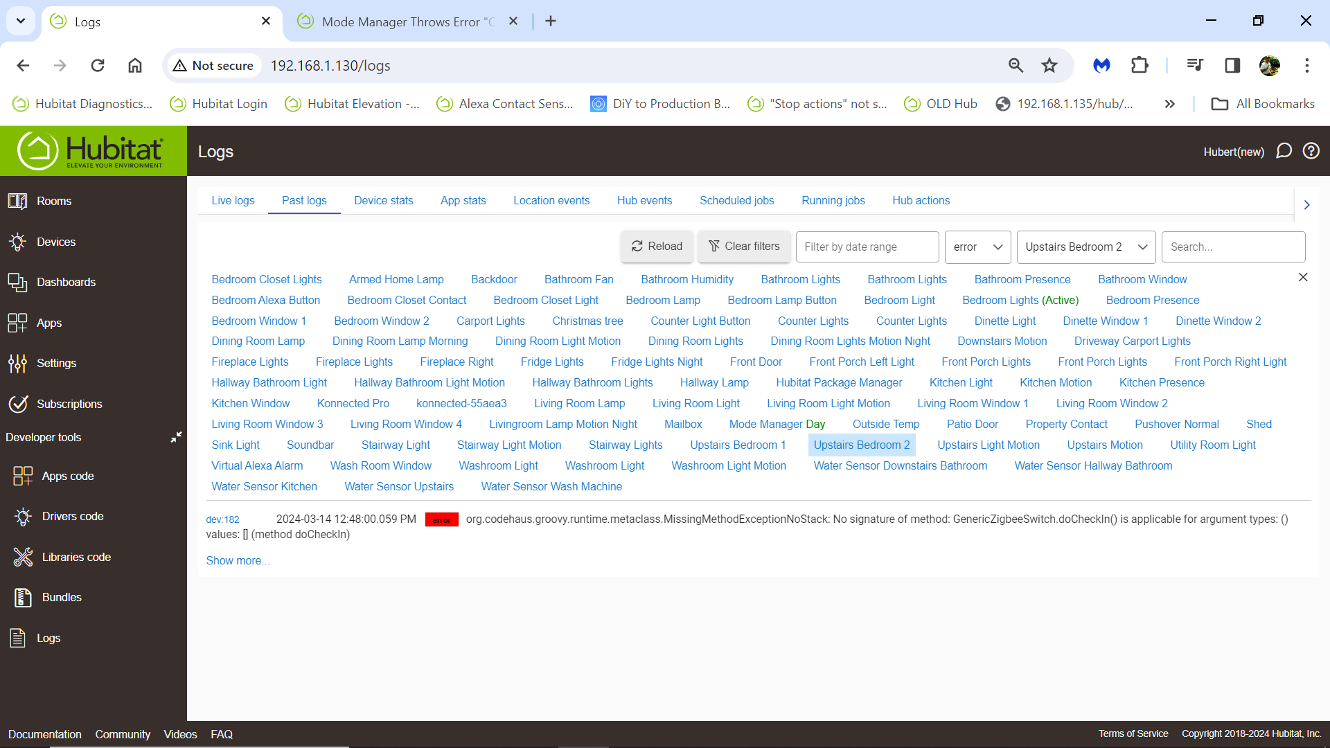

Can someone help me with this, I have been getting this error every day at the same time. The device is a zigbee GE Enbrighton switch M# 43084. I physically replaced the switch with a zwave switch and used device swap. Sometime later reinstalled it in another location, never removed it from the hub. Also some of the data is not listed on the device page comparing it to other identical enbrighton switches I have installed.
It looks like you must have previously been using a different driver that created a scheduled job that the current driver does not use. One solution is to:
  1. Change to the "Device" driver temporarily (scroll down on that page, somewhere between your first and second screenshots, and change "Type" to "Device," then hit "Save Device")
  2. Run the "Delete All Scheduled Jobs" command (click/tap the button to run the command)
  3. Switch back to the driver your intended driver.
If you didn't do it when switching in the first place, you may also want to run the "Configure" command after switching to this driver again (if this command is available).
Thanks, did what you said. Will keep check on the logs. Today is cleanup little hub issues that bug me.
