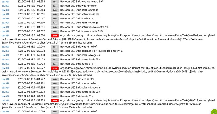

On my C-7 running 2.4.3.137 I'm getting this error
The actual physical device is a ZW Fibaro RGBW controller, but I chose the Generic RGBWW driver for it since it works best of all I've tried.
Is there anything I should check to make this error go away? I can't help thinking it's somehow connected with times when the Fibaro doesn't turn off (as part of a Mirror routine).

Yep, still happening on the daily. Wonder what this means . . . ?
Thanks for looking. For me it means random failure to switch on.

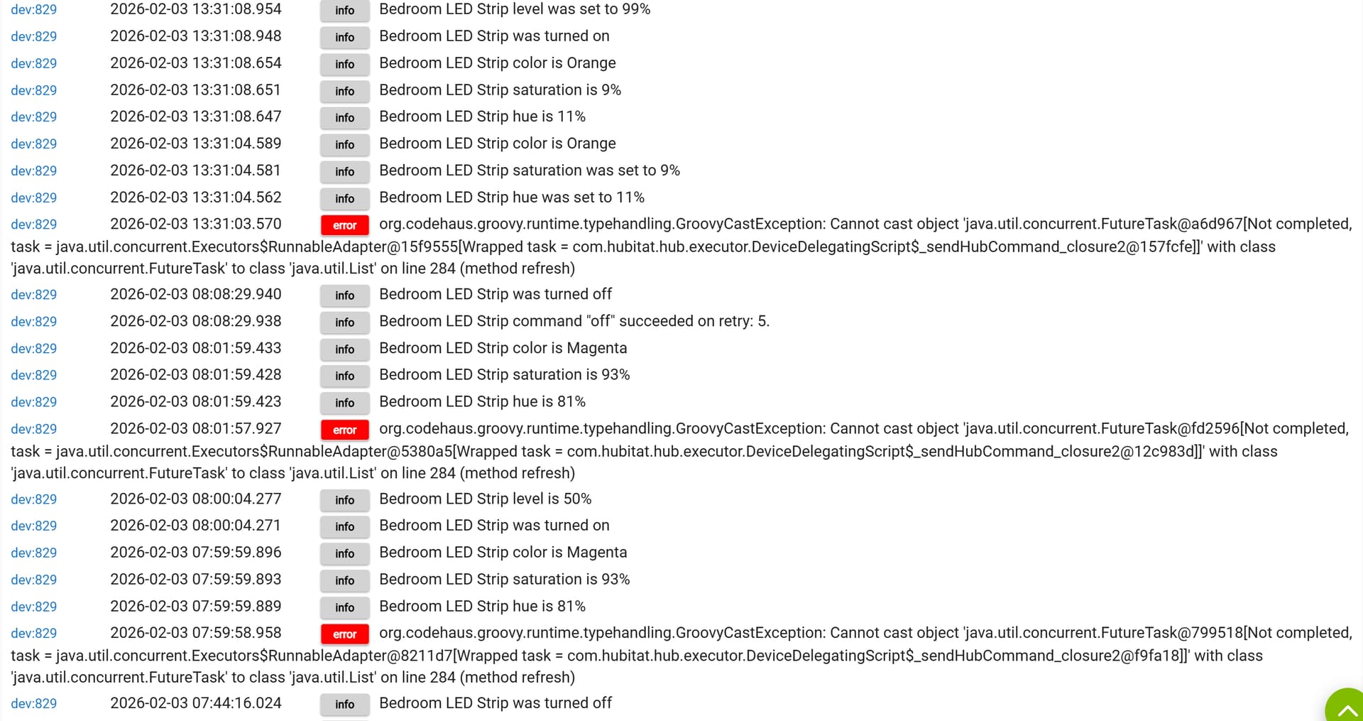

This is my log for context
Could you please send a private message to @support_team along with your hub id so we can take a look at your engineering logs?
will do
Fix will be in next release. Many thanks @bobbyD for your super fast diagnosis and resolution!
