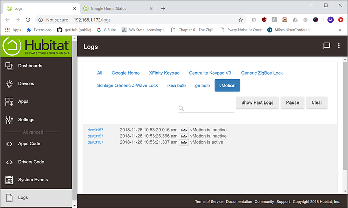

I'm not seeing this issue with the driver itself
Thanks for checking!
I just created one myself and worked fine too, should have tried this before. Comparing them noticed the one giving trouble said "Click to Set" on the "Auto Inactive" preference, I set that to Disabled and its now working fine!
