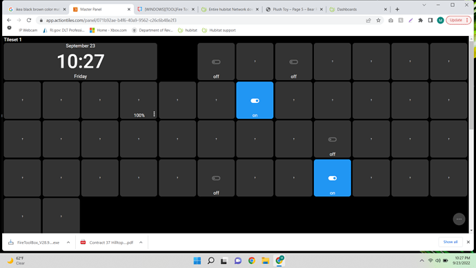

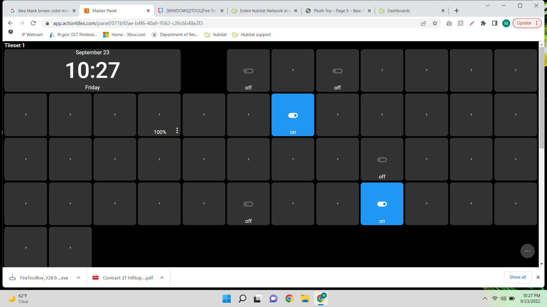

Hey guys. I'm pretty sure I updated to 141 or 142 yesterday or the day before and it was running fine. Now nothing is working. I can't even load my devices page and all my dashboards just have ? on my devices. No commands through Alexa work either. Anyone else have an issue after the update.

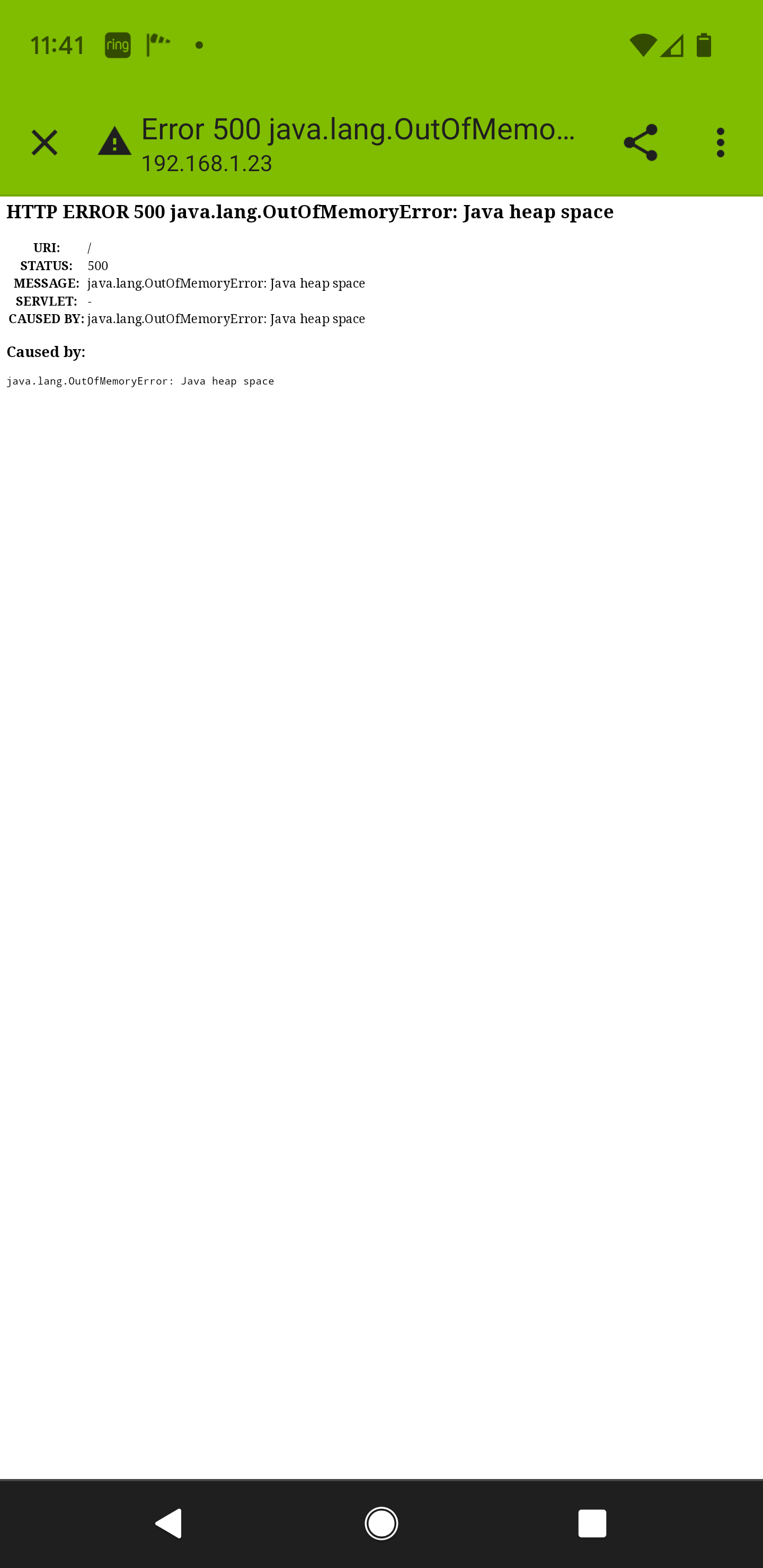

The out of memory error, will require a reboot to resolve.

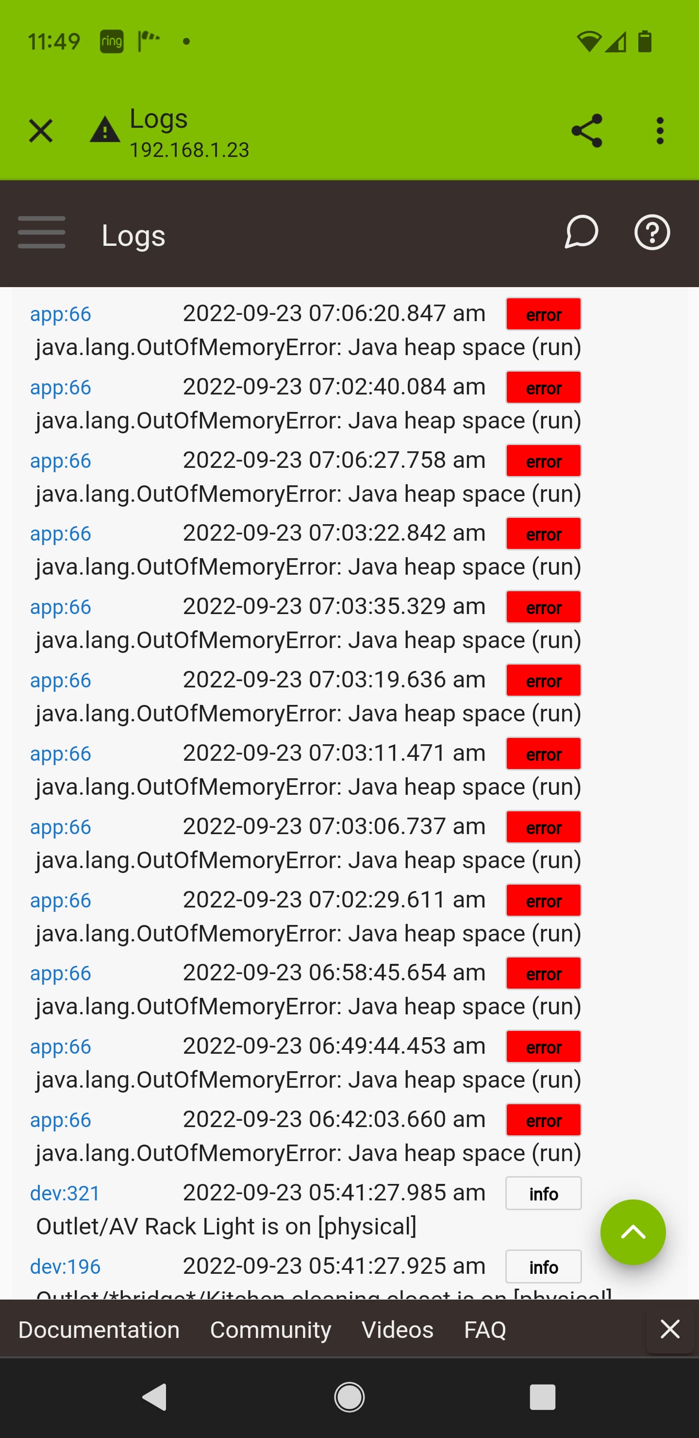

What is app:66?

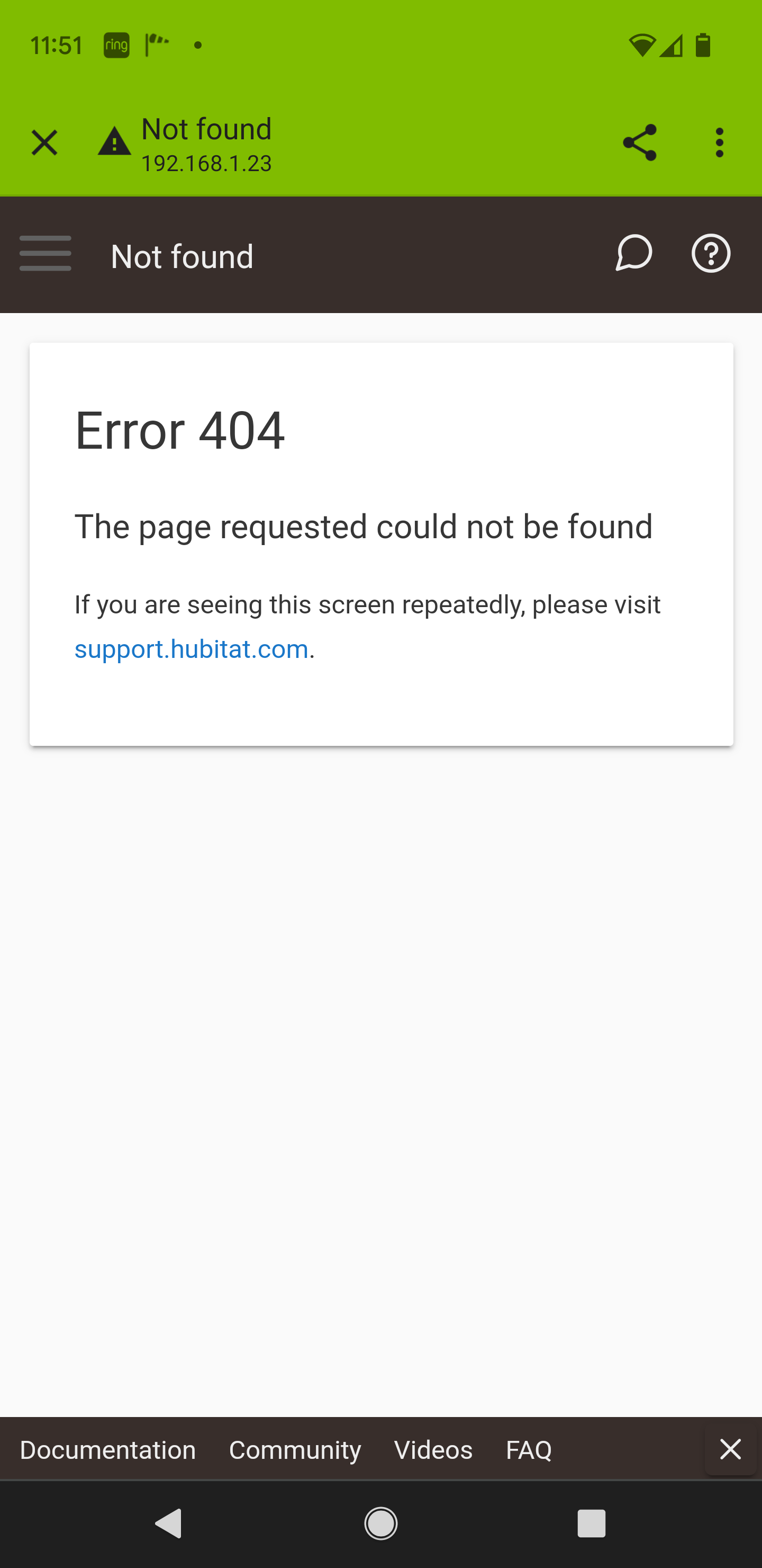

Please reboot your hub and see if the problem persists. I am seeing that you have updated to the latest version (2.3.3.121) but the screenshots show older update version.

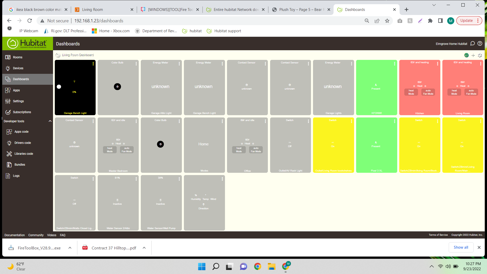

Wanted to button this up. I again did an update and it appears everything is working. Well see if all the rules and automations run tomorrow. As always, appreciate the help.
Edit: For some reason my dashboards wont populate. Will tinker more tomorrow.
