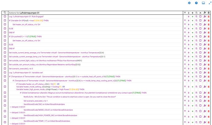

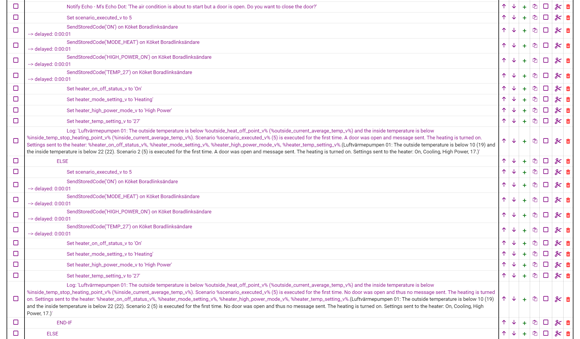

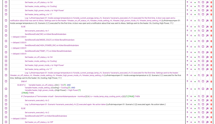

When I have bit of time I often change this rule to tweak it in various directions. But here is the current 'production' version (which will be changed shortly).
This bit here is not part of the rule, it's just me fiddling with global varables to understand how they work, so please disregard that.
