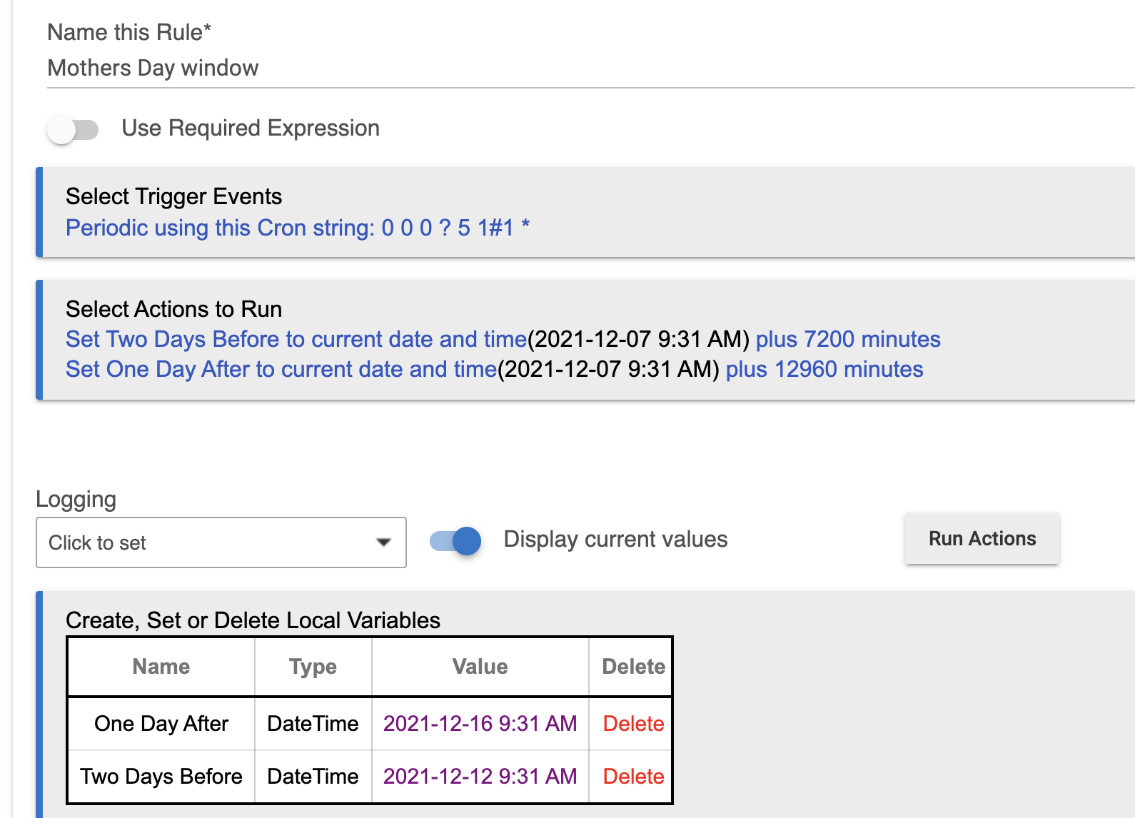

You can already come up with something that does what you want to do using a Cron string and a rule that sets two variables. That rule would have this Cron string as its Periodic Schedule trigger:
0 0 0 ? 5 1#1 *

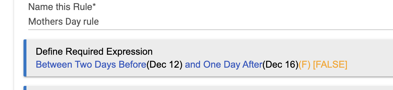

That fires on the first Sunday of May every year. What we want is a variable date that is five days later, and one 9 days later (midnight after the Monday after Mothers Day). Like this, only this should use Hub Variables not Local Variables (I used Local so you could see what happens).
I used Run Actions to set the two variables today, just to demonstrate what happens. You can see that Two Days Before is set to 5 days from now, and One Day After to 9 days from now. These two variables become the Between Two Dates condition for the Mothers Day rule.
Each year, these are reset, and the Mothers Day rule only runs during that period.
Like this:
I forgot one thing, I probably should only have used 8 days after, because Between Two Dates runs to the end of the second date, which is what we want.

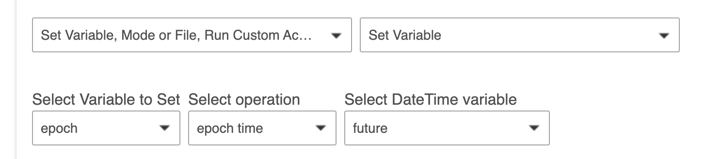

RM can do this directly with setting a number variable from a DateTime variable:

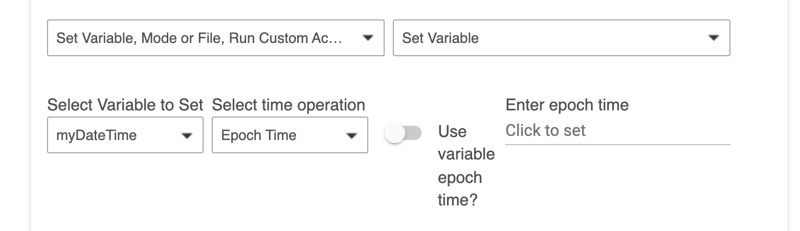

It is also possible to set a DateTime variable from an Epoch time:
