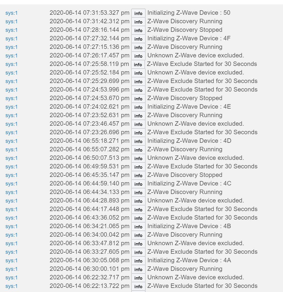

I am trying to include an Enerwave RSM2-Plus Zwave Plus dual relay. I have tried 6 times. Every time it get stuck "Initializing." I have tried all the usual tricks. I excluded before including (exclude succeeds). I have rebooted the hub several times. It simply will not include. Does anyone have any suggestions? I only bought this device because so many said it works great with Hubitat. I am on 2.2.1.116
Edit: I also have the device only about 12in from my hub

I've failed 20 times now so I'm going to have to wait for @bobbyD or @mike.maxwell to have some ideas logs show nothing useful. Even more annoying, while excluding the device my Zooz Zen30 (which no one was even touching) excluded itself and broke various rules. No idea what happened there... I think I need some expert help :frowning:
