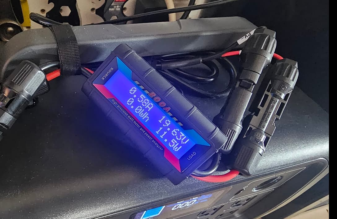

There are mini power meters, with little lcd displays, that could be connected in line with the MC4 connections on the incoming solar wires, but the searches I've done failed to turn up a zigbee or zwave enabled device.

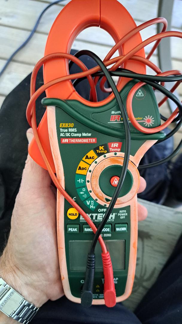

I'm pretty sure I measured DC amps on my multimeter.

It would be cool if a little meter like this was smartified:
Yeah, it was my clamp on multimeter I was thinking of:
