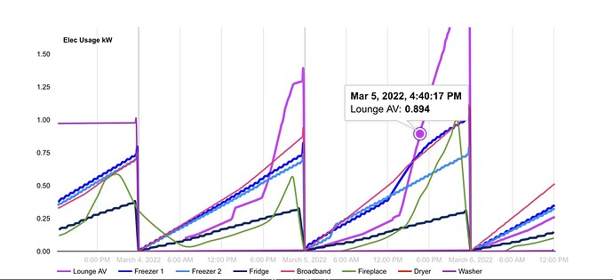

I use this graph to watch key higher energy usage devices that are somewhat variable, I include fridge/freezers to monitor their health.
20%-25% of my annual usage is my stuff that uses just a few watts 24/7. For example, my HVAC (furnace) and fridge use 10 watts continuously, each. 23 watts for my modem, router, switch, & wifi mesh repeaters. 30-40 combined watts for other smart home gear. 5 watts each for my garage door openers. And a pile of stuff in the 1 to 5 watts range. All together it adds up to about 225 watts continuously or 2000 kWh per year. I've been thinking of what I can do to whittle this down, but haven't really seen any low-hanging fruit at our current electric rates (0.11 USD per kWh).
My largest individual devices seem to be the usual suspects...
(Note that we use Natural Gas for hot water and HVAC heating)
Electric Dryer: About 800 kWh per year. I've read that heat-pump-based dryers are supposed to cut energy use by 20-60% and, because they have their own internal condenser, they don't need to be vented. These don't seem to be widely available just yet. In the meantime, I've read (but haven't verified) that using the delicate setting takes longer but does reduce energy-per-cycle.
Clothes washer: Based on the three loads we washed this weekend, my washer uses about 0.15 kWh per load (with the extended final spin cycle). I bet we average 4-5 loads per week or 30-40 kWh per year. Not much to be saved here, I'm afraid.
Refigerators/Freezers: Our main fridge uses around 700 kWh per year (NOT counting the 10 watts of continuous power), but we've also got a chest freezer (230 kWh/yr), and upright freezer (320-470 kWh/yr), a garage fridge (aka "The Beer Fridge", ??? kWh/yr), and an under-counter fridge in our basement family room. Maybe we could eliminate one of the freezers, but my wife likes to buy in bulk and stay stocked up for our family of 4.
And finally HVAC. I don't feel like I've got a good baseline on this yet. My first real Hubitat project was to implement zoning based on thermostat mode/occupancy. For this winter, the gas bills show that we've been in the 20% most efficient homes. We've also adjusted our heating setpoint fairly close to the lower limit of our comfort range. Any cooler and I'll likely have a mutiny on my hands. This summer I'm planning to tinker with a dew point control similar to what @aaiyar is using.
I am using a heat pump clothes dryer, it uses 0.8 kWh per dry on average, more for heavier clothing. As part of the preparation to moving to an electric night storage system my wife has been doing only one wash/dry per day, 5 days a week, too keep under the three battery loading. It does take a little longer to do drying but not really noticeable. We like it because you can drop it anywhere, although convenient to run a small pipe into a drain is always nice, so you don’t have to keep emptying it.
The large fridge comes in at 300-400 W per day, the two upright freezers use about 750 W per day, they are all 6 ft tall matching units. Getting close to only using the one freezer.
I found the best way to determine ‘ghost’ usage was to look at power being used in the middle of the night.
Originally it was 700 Wh, now it is nearer 300 Wh,
As I recall, 45 Wh were down to the 90 hue lights on standby, which I can live with because they enable automated, motion controlled lighting and figure they more than save 1 kWh of power per day over the bulbs they replaced and are extremely convenient.
I was surprised that the UniFi Dream Machine was using 1kWh per day, which at the way tarries are going is going to cost £182 per year to run alone, not that Want to replace it.
