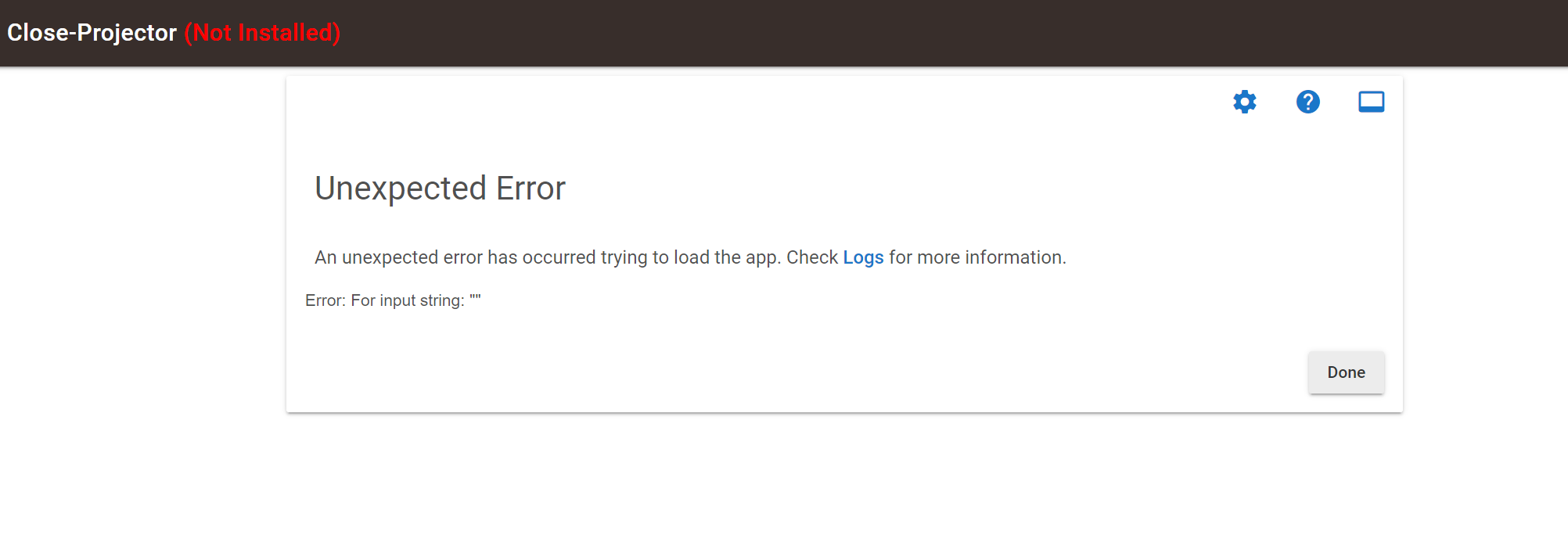

I played around with Hubitat for a few months and trying to slowly automate my home. When I tried to add actions in a simple rule using Rule Machine 5.0, I got the following error message
Unexpected Error

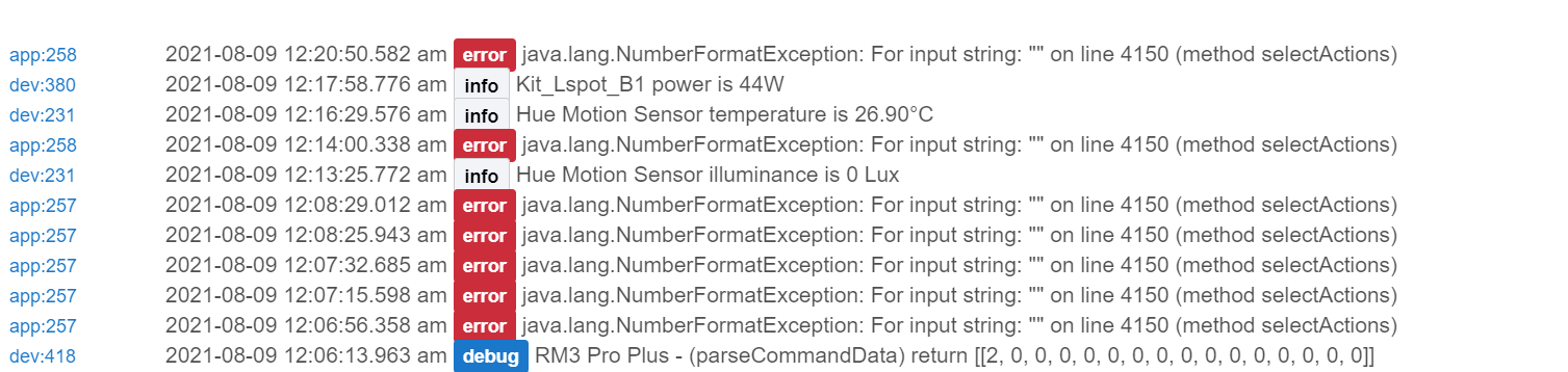

An unexpected error has occurred trying to load the app. Check Logs for more information.
Error: For input string: ""
Then when I tried to edit the rule again, I consistently received the same error message. I'm not sure how to avoid the error. I even tried to delete the rule and create the same rule again and got the same error at the same place. The error log is
"java.lang.NumberFormatException: For input string: "" on line 4150 (method selectActions)"

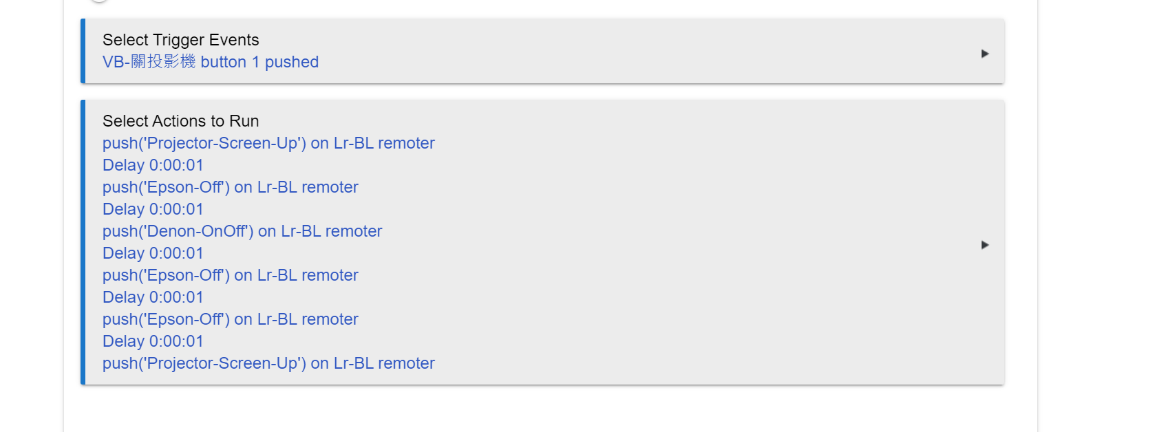

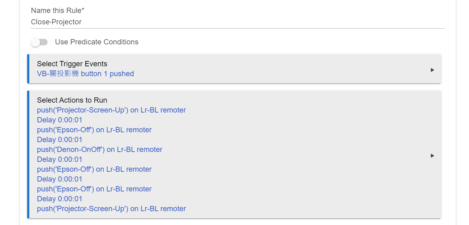

My rule is as simple as a sequence of actions like the following:
push('MOD-OnOff') on Lr-BL remoter
Delay 0:00:01
push('other cmd 2') on Lr-BL remoter
Delay 0:00:01
push('other cmd 3') on Lr-BL remoter
Delay 0:00:01
push('other cmd 4') on Lr-BL remoter
Delay 0:00:01
push('other cmd 5') on Lr-BL remoter
Delay 0:00:01
The error occurred when I tried to add one more action. It'd be great to get help from the community :slight_smile: Thanks!

It would help if you could post a screenshot of the rule here. Also, what is this device 'Lr-BL-remoter'? Are you using Custom Action? If so, what is the parameter type you selected? It would also help if you could post a screenshot of the Logs where the error is showing up, so I can see the entire message (no copy/paste).

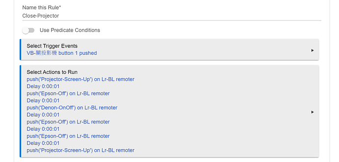

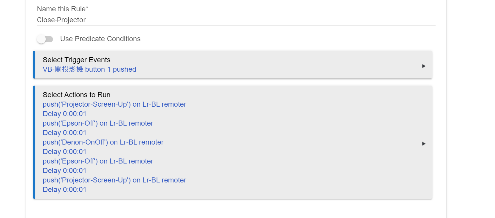

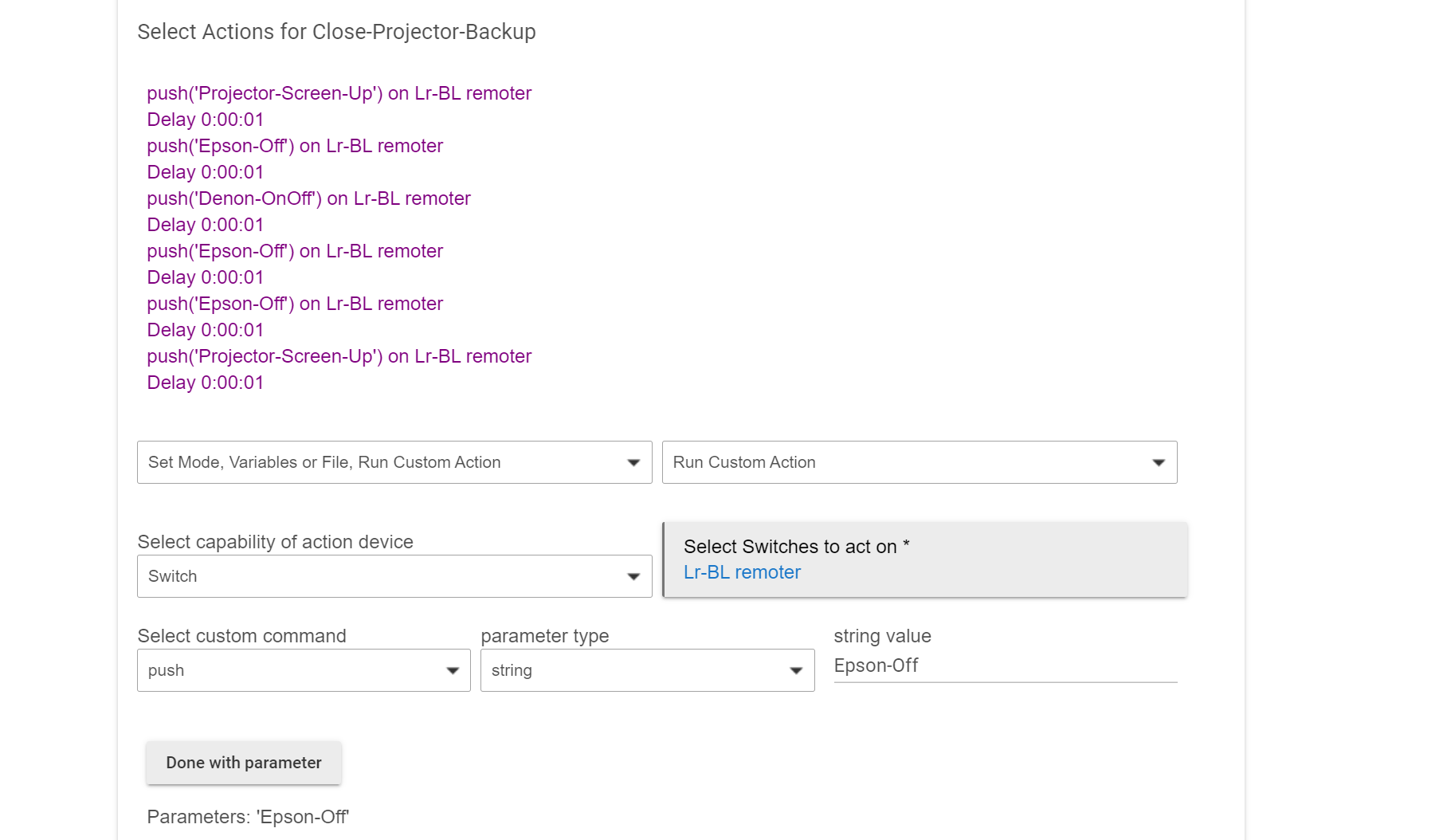

Great, thanks! The screenshots are attached. Also the downloaded rule is here: https://www.dropbox.com/t/Rm2Uvd1uFcit03W3

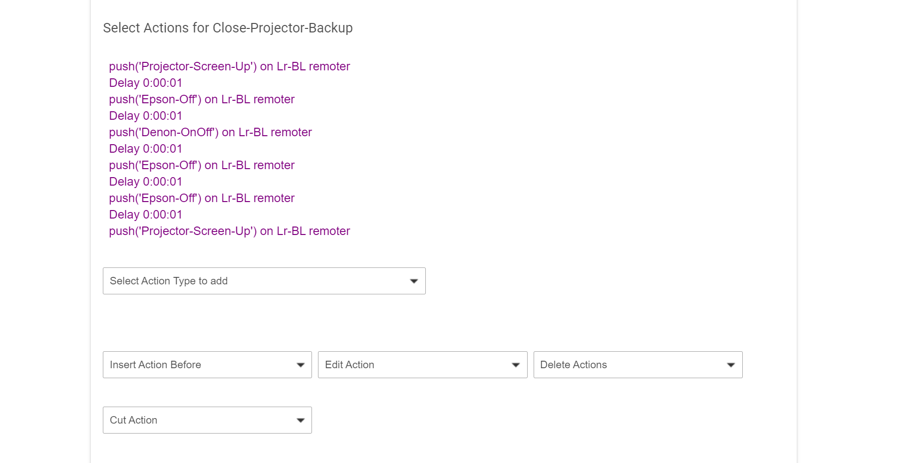

I also tried a bit more to change the order of actions and managed to avoid the bug. A screenshot of the working rule is also attached in case it helps.

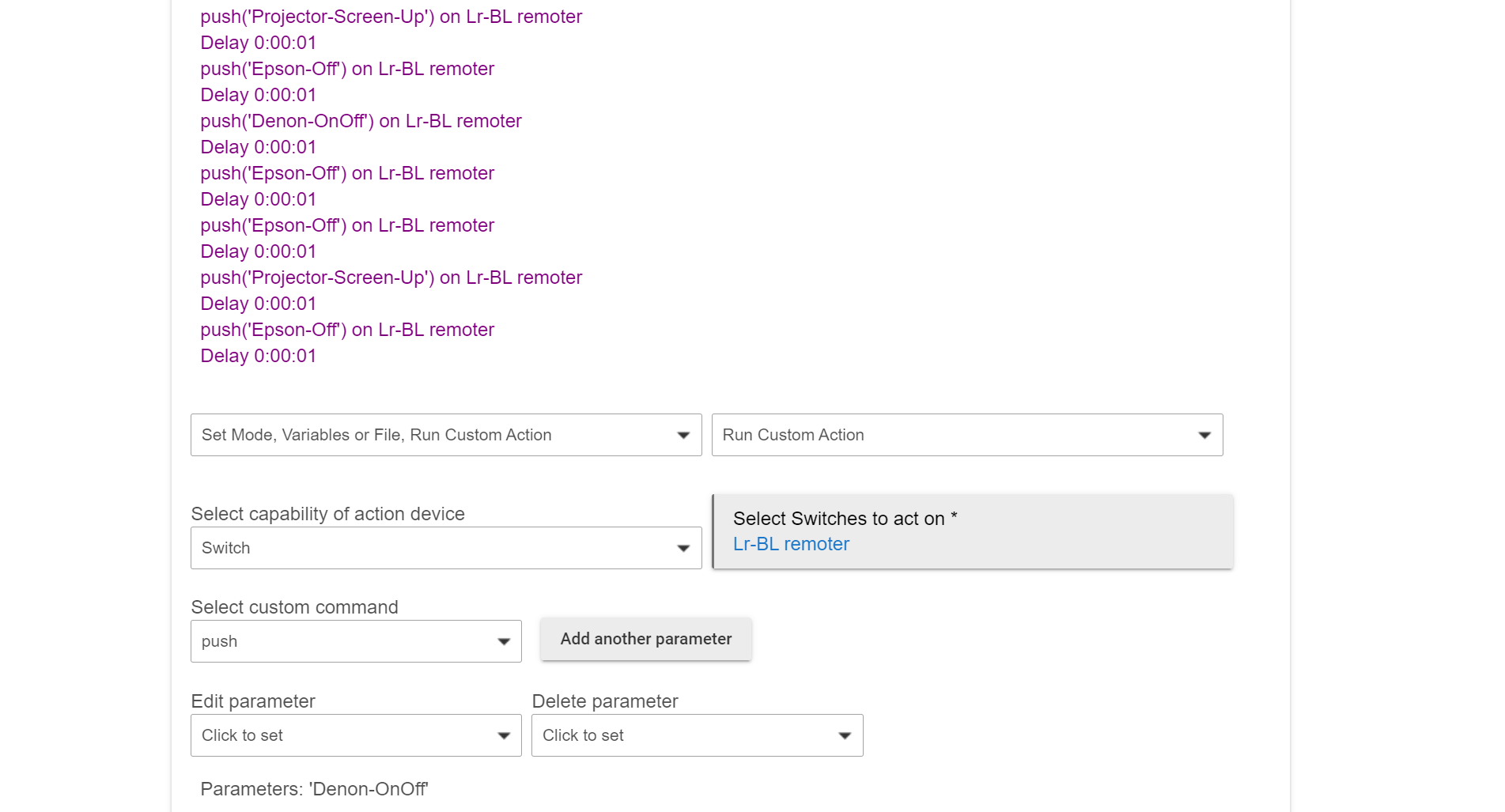

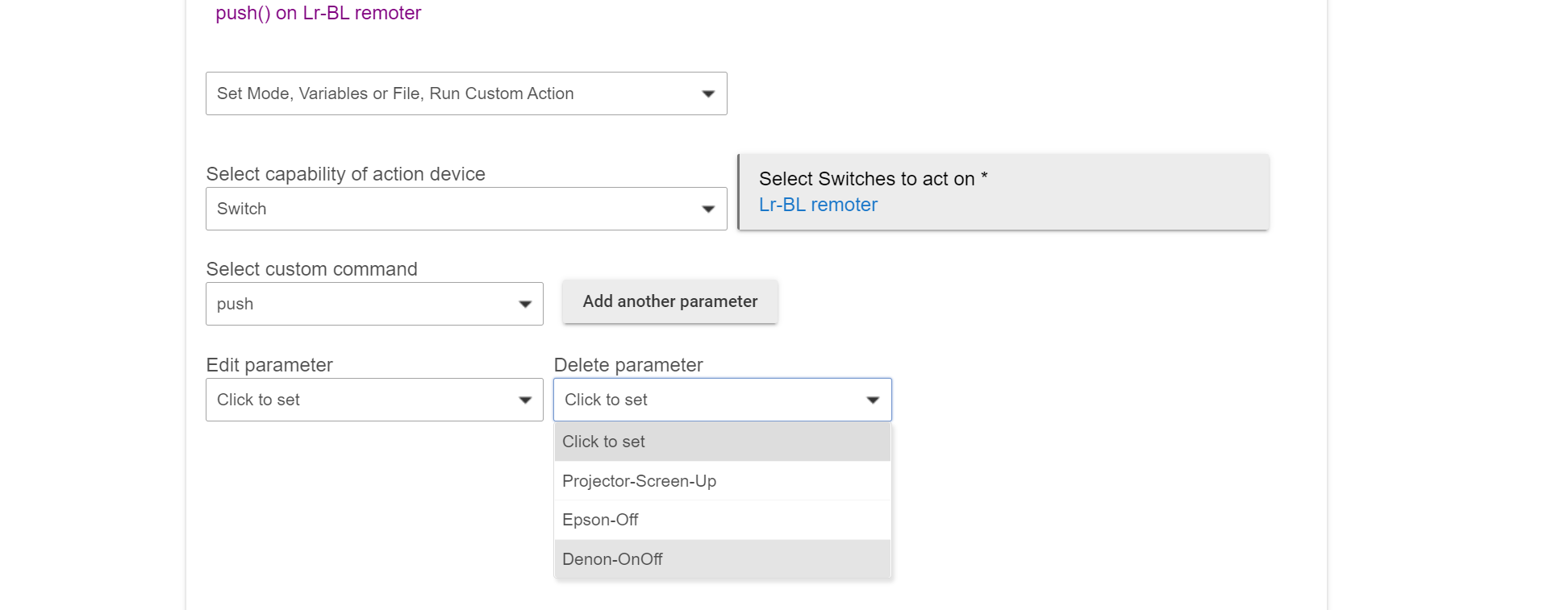

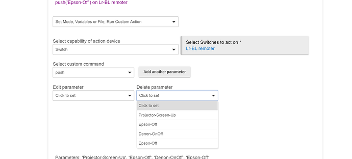

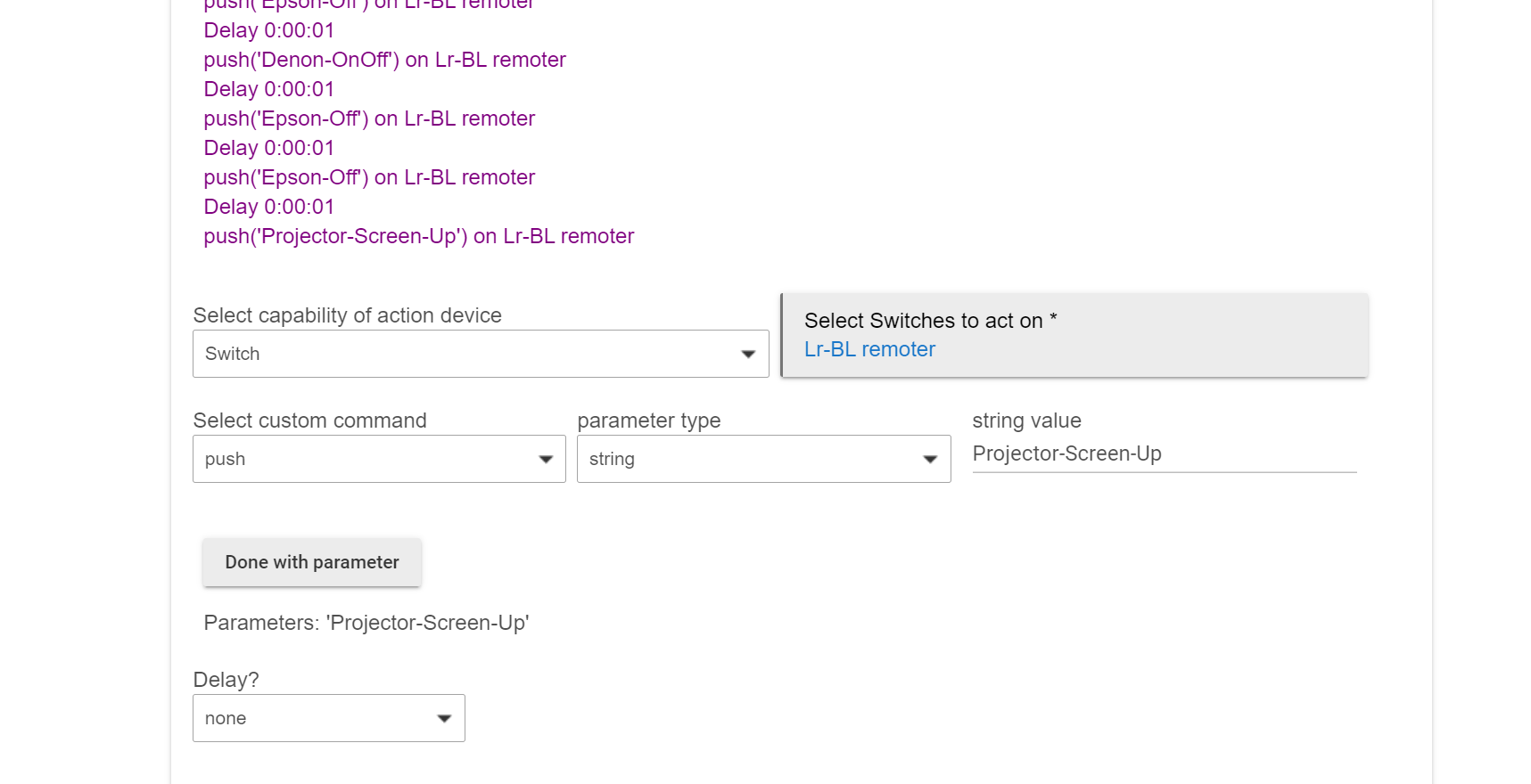

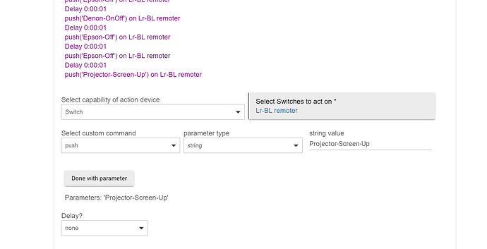

It looks like you maybe set the parameter type for the push command to be a number, and it's choking on a string. Please open the rule, and edit the custom action for the first action, and show that screenshot.
I'm pretty sure that I use the string type. I had entered the rule twice and saw the consistent bug. Here is the screenshot of editing the custom action.

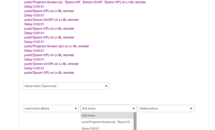

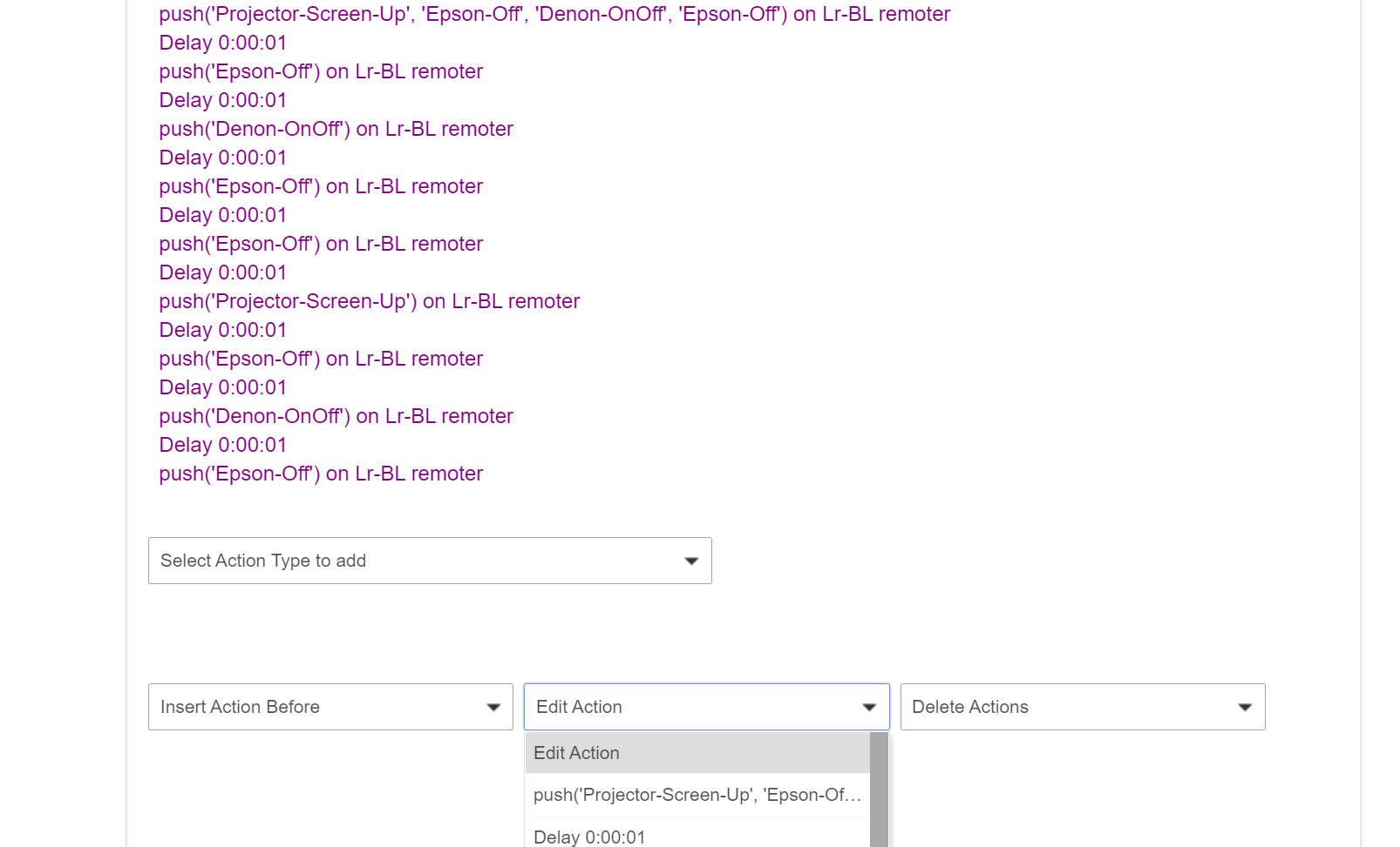

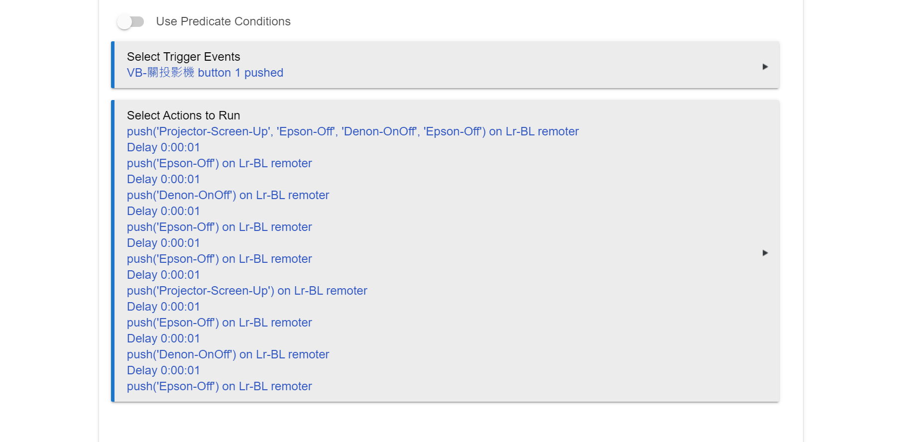

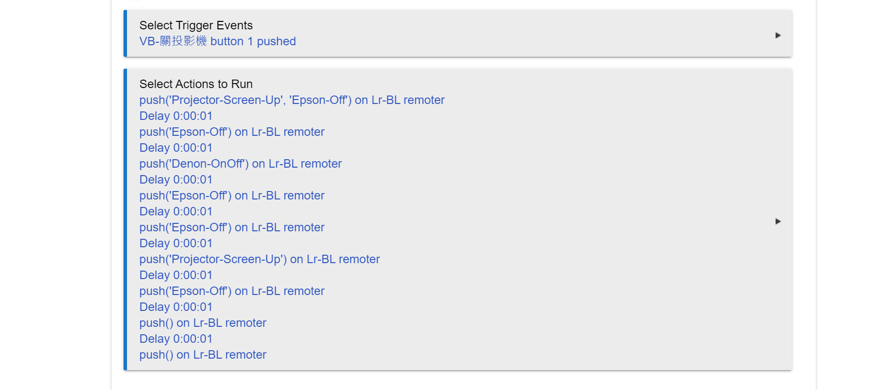

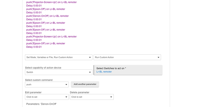

It also seems that I got strange behavior when I have > 10 lines of rules and >5 custom actions like that. I didn't record screenshots, but it's something like what I entered for the last action, say, push('Epson-On') will also be inserted in the first action, say, change push('Projector-Screen-Up') to push('Projector-Screen-Up', 'Epson-On'). And when I deleted the 'Epson-On' in the first action, the 'Epson-On' in the last action also disappeared, i.e., change from push('Epson-On') to push().
Now I avoid the issue by breaking the rules into sub-rules and use Run Actions to call the sub-rules. It's stable so far so I'm kind of fine for now, but I suppose it's nice to get the (reproducible) bug fixed :slight_smile:

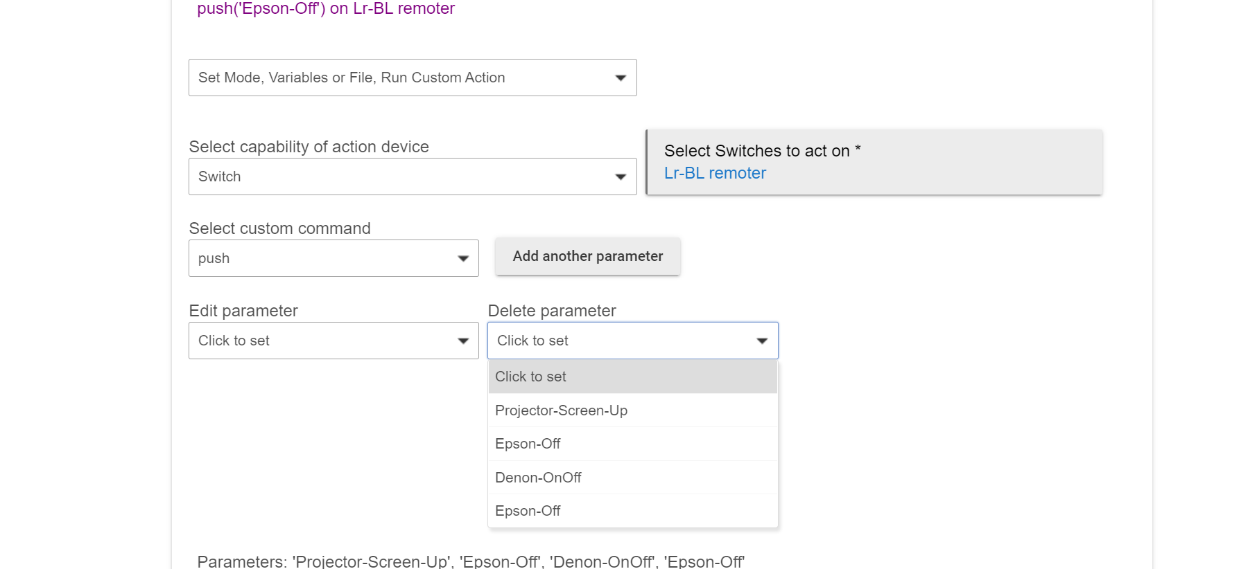

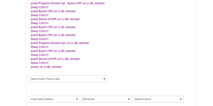

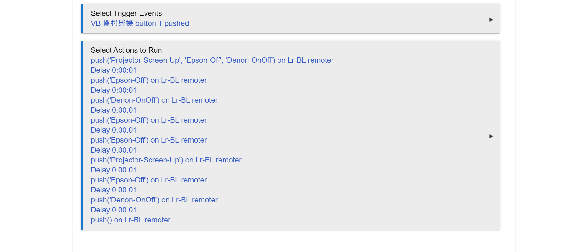

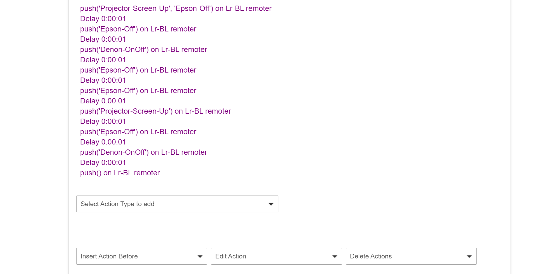

I managed to get the other reproducible bug with screenshots for reference. In the following, I tried to add custom actions with different string commands, and at some point, the added string commands appeared in the first action command. When I tried to remove the first action command, the corresponding command in the last action got deleted as well.
I realize now that the fix for this issue is in the next release.
