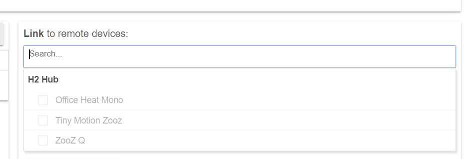

@gopher.ny this screen is less than what you see is what you get. It does make sense to grey out already existing connected devices but not showing the checkbox as checked gives the impression they were once connected but something is not working properly and now they are not. Am I misreading what I see here?
Now that you said it, having a checkbox on devices that are already linked to locally is more intuitive. I'll make the change for 2.2.8.
