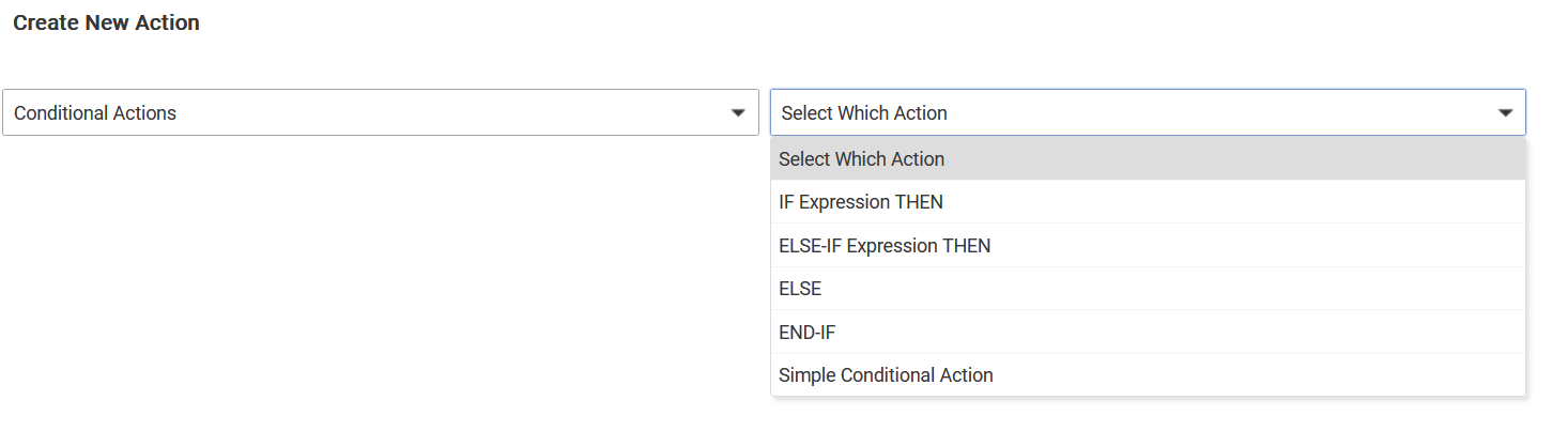

And then the video and I diverge because, in attempting to add the ELSE-IF, there's no option to do so in the Conditional Actions
dropdown as there is in the video:

You haven't defined a conditional action in the Actions for... section.
Please start here
Create New Action
Selection Conditional Actions - IF Expression THEN
When defining the IF-THEN you can use existing conditions and pull one, or eventually multiple, from the Manage Conditions section.

Where am I finding the ELSE
and END-IF
EDIT: wow, ok, must do Done with IF Expression THEN
and go back to the main rule menu and +
END
and END-IF
