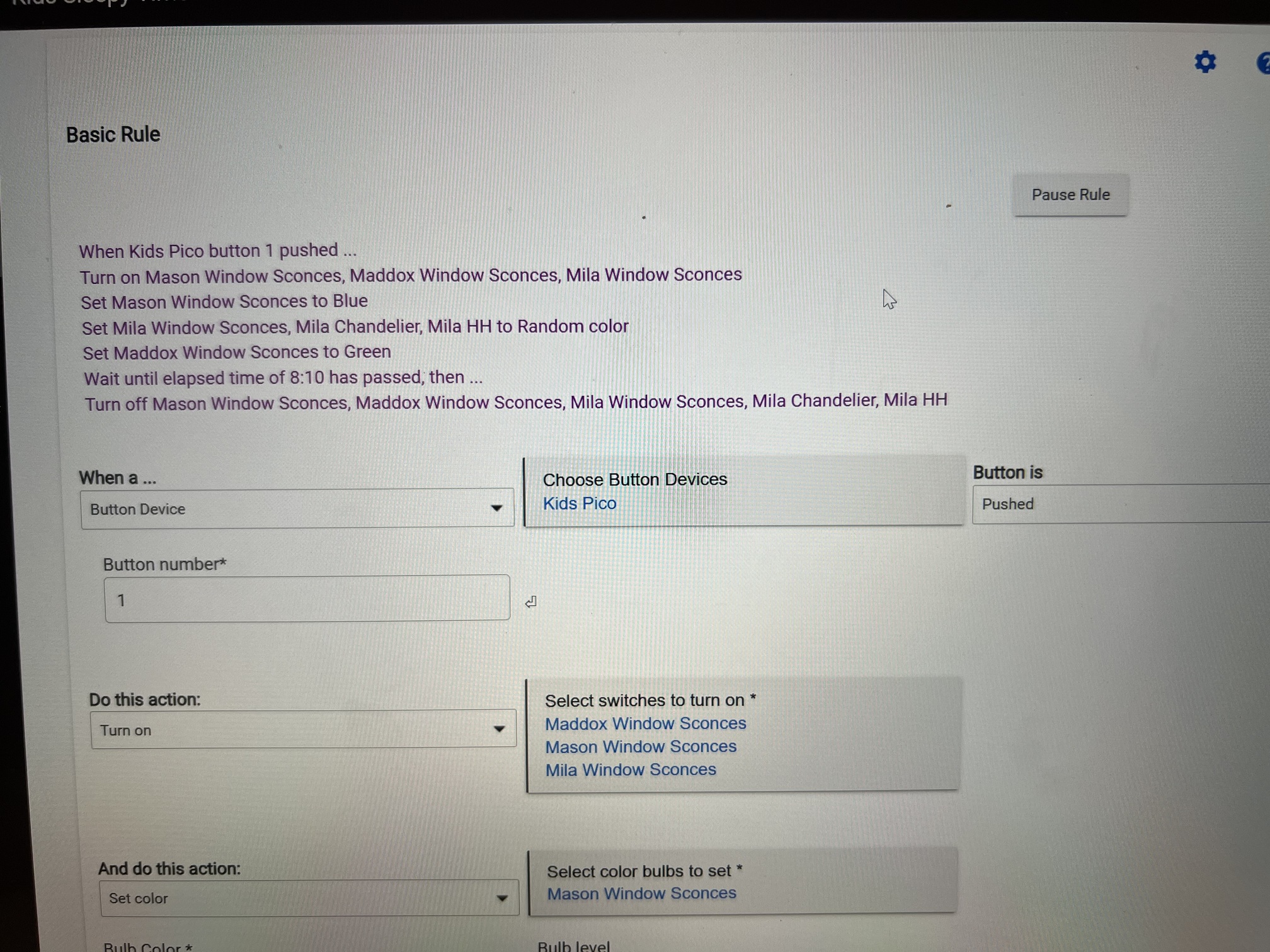

If someone could comment please. Basic rule not turning off after elapsed time. What am I doing wrong.

What I’m trying to accomplish is an automation that once a button is pushed specific hue lights will be set to a color and intensity in my three children’s rooms for a period of time then shut off.

So earlier ran this app and didn’t turn off. No errors.
Ran app a second time and all ran well turned off.
Last run got log warn error communicating with hue bridge. HTTP 408. Which I occasionally see with two of the six bridges I have connected to my network.
